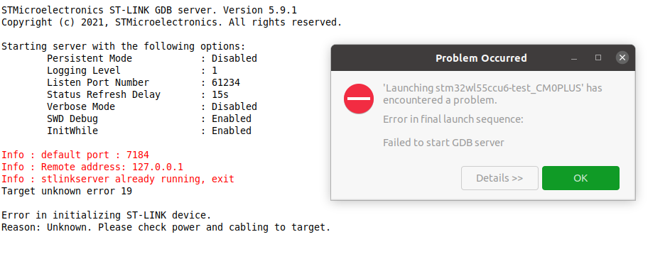

I stuck here
I found a similar problem on this forum.

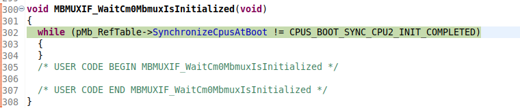

Of course, I can't debug Cortex M0.
But it doesn't work in my project. I replaced ***.ld and ***.s files for M0. Would you please reproduce it and give me some hints on how to start Cortex M0 core?
