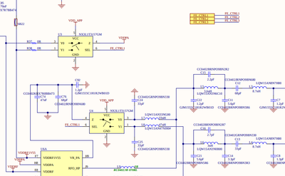

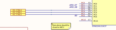

circuit from :
https://www.st.com/en/evaluation-tools/nucleo-wl55jc.html#cad-resources
...to be sure, power to RF/PA is really OFF, when you expect it and measure current.
