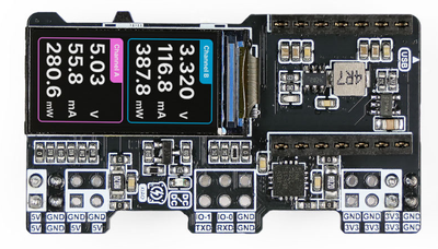

When I measure the current using a Xiao PowerBread, I get around 20 mA on the 5 V rail, even when the MCU enters Sleep Mode.
On a related note, I would be careful with such a device.
Said Xiao board uses a 13-bit ADC for current measurement, which gives you an accuracy of about 1/8000 of the full range at best. And you find very little about accuracy and tolerances in the specs.

@Mariiian09 wrote:I measure the current using a Xiao PowerBread,.
You mean this: https://www.seeedstudio.com/XIAO-PowerBread-p-6318.html ?
As @Ozone suggested, that's not going to much use in this type of application.
The current consumption in this type of application is very "peaky" - you're not going to get anything useful by just looking at displays.
Not even with a proper multimeter.
What you need is something like the STLINK-V3PWR or X-NUCLEO-LPM01A - that will give you a proper, real-time view of the current.
