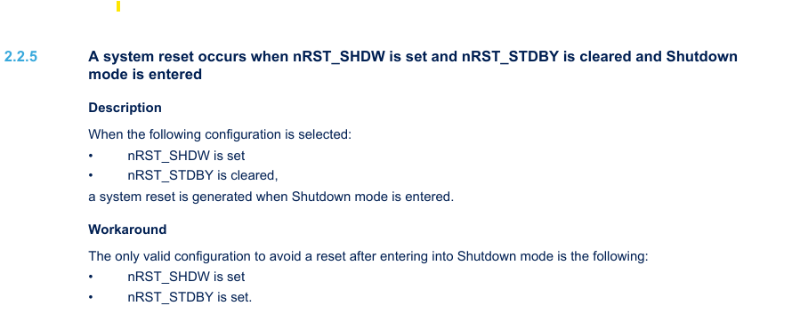

Hello @onass
Did you check if your case is related to the known limitation documented in the errata sheet?
