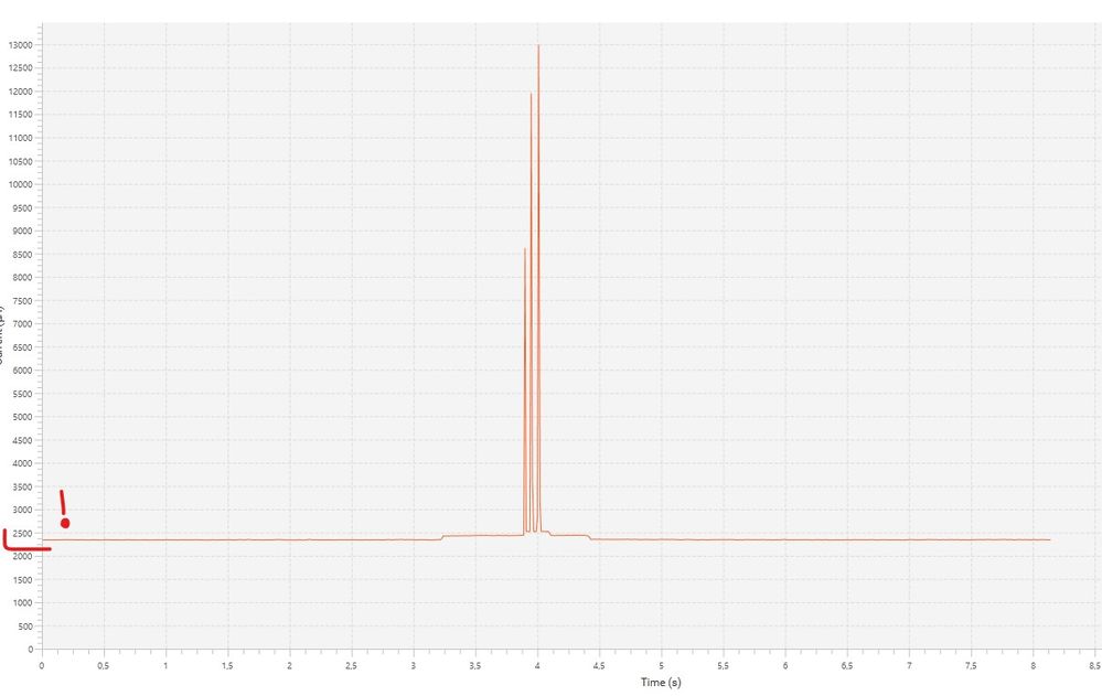

I was able to successfully reproduce the On/Off Client SED with NVM and low power consumption (around 3 µA), measured using the ST-Link Power Monitor. However, in that example project, a timer is used to trigger the On/Off commands.
I created a new application that uses buttons instead of the timer, but now the device never enters sleep mode and behaves quite strangely. Based on the current consumption spikes, I can see that the device is transmitting data. In Wireshark, I can see that packets are being sent, but Home Assistant does not react to the commands at all.

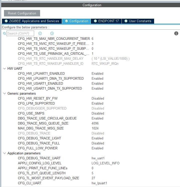

power consuption
zigbee conf

Hello @Eldar_Duss,
I have tested the file you shared with the config enabling both button + NVM and seems to work properly in my side.
Device goes to LPM mode after the join, we can see peaks after each push and then it reenter to stop mode as expected.
Could you please test the application using another Nucleo board, I suspect a HW issue with the board you are using since this is working on my side.
