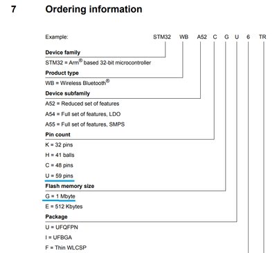

And according to the MCU datasheet WBA55UG means:
So yes it's a UFBGA59 package with 1MB of Flash:

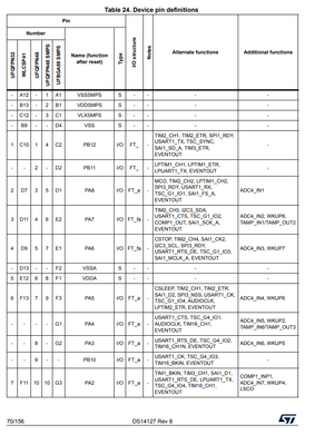

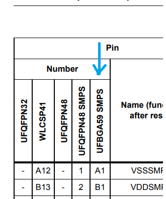

From the DS14127 link: https://www.st.com/resource/en/datasheet/stm32wba52ce.pdf
I can see the pin description (Table 24):
What document link you are referring to?
PS: xxSMPS pins are supply pins and not GPIOs.

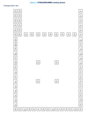

The datasheet is for the microcontroller but STM32WBA5MMG is a module:
STM32WBA5MMG datasheet: https://www.st.com/resource/ja/datasheet/stm32wba5mmg.pdf
This is the module pinout, normally each pin has the same alternate functions as described in the MCU datasheet.
