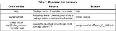

The manuals suggest using the following commands to download and install FW packages:
I've placed those commands in a script
swmgr install stm32cube_f4_1.28.0 ask
exit
and executed the scrip via PowerShell:
& "$env:STM32CubeMX_PATH\jre\bin\java" -jar "$env:STM32CubeMX_PATH\STM32CubeMX.exe" -q .\myscript

It seems the swmgr install command is functionally useless anyway as according to the usage I can only (deny|ask) the package license. There is no accept option?
Usage:
swmgr swmgr install <full_cmsispack_name | full_firmware_name | full_filepath> <licence_mode (deny|ask)>: install specified Cmsis packname or Cube Firmware with se
lected license accept mode.ask - negates the entire concept of command line where you don't want to interact with a UI as it pops up the license acceptance dialog and freezes for user input.
deny - downloads the package (yes, goes through the entire download) and then tosses it out because you automatically deny the license. So net is a NOOP where you downloaded an 800Mb file. Seriously, who actually authored this API and what possible use case does this represent?
