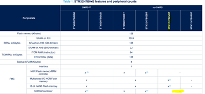

For my current Project, I decided to go with the STM32H7B0VBT6 from the STM32H7B0VB family. However the 1.4MB SRAM of the MCU was too little for me, so I've chosen to go with an external SDRAM (IS42S16400J-7TLI [64 MBit | 8 MB). Now I wanted to get the pinout for the SDRAM from the STM32 (I use STM32CubeIDE), however under FMC, I can't find the SDRAM section (See attached Screenshot). I find it odd, because the Product description and the Datasheets state, that this STM32 supports external SDRAM ("SDRAM/LPSDR SDRAM" see Datasheet: https://www.st.com/resource/en/datasheet/stm32h7b0vb.pdf or Product page: https://www.st.com/en/microcontrollers-microprocessors/stm32h7b0vb.html#st_circuit-diagram_sec-nav-tab )
So I wonder if there is something that I missed.

The STM32H7B0VB (LQFP100 package) does not support SDRAM. This is because the 100-pin packages do not have the necessary multiplexed mode for SDRAMs.
Please check this detail in the STM32H7B0xB Datasheet (page 7) Table 1. STM32H7B0xB features and peripheral counts
If you need SDRAM support, you will need to choose a different package that supports SDRAM, such as those with more pins (e.g., LQFP144 or higher).

Thank you very much for your fast response. I guess I have to chose another Package then.
