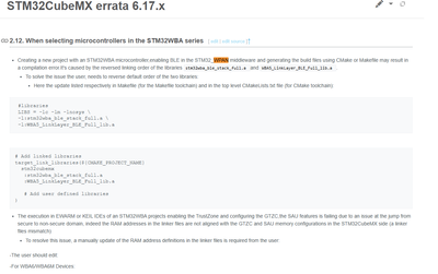

I advise you to have a look at the Known limitations when selecting the STM32WBA series using STM32CubeMX.
