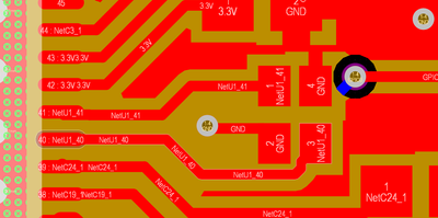

(The four pad footprint is the crystal connected to pins 40 and 41)
This is my layout and after some more research, I now think that I needed a ground "ring" and more vias returning to the ground plane around the crystal as recommended in this document.

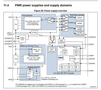

2025-06-04 8:01 PM
Thanks for your response.

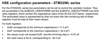

I saw the section in AN5042 about the HSETUNE[5:0] register already. What I meant by "a specific capacitance" was how the values, 0-63, correspond to a capacitance in pF. (Like how its stated for the STM32WL)
Anyways, from your comment about power, I double checked my schematic and realized I made a dumb mistake by forgetting to power up VDDRF which powers the HSE.
I haven't been able to add a bodge wire yet but I'm assuming it will fix my problem.
Thanks for the help.

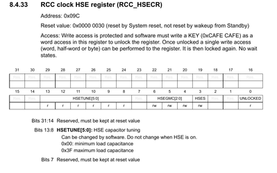

2025-06-02 11:05 PM - edited 2025-06-02 11:11 PM
your crystal + layout looks ok.
>but I was unable to find how the value in the register maps to a specific capacitance
-> Refer to AN5042 for the HSE trimming procedure.
ok, just see rm :
(I dont have this chip...) Is there nothing to set the HSE in Cube ?
If not : set a value with "average" values , i would try :
- before the start of the hse
- unlock register
- write 0x2FA0 (just guessing...try. or 2FF0, max drive) to RCC_HSECR
-> read AN2867 “Oscillator design guide for STM8S, STM8A and STM32
+ all voltage levels ok ? smps ...working?
