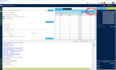

Current state of Option bytes:
I didn't change anything here.
I've tried different states of BOOT0 switch on the board, but nothing changed.

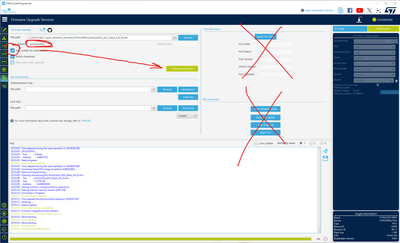

2025-06-04 10:41 AM
I'm not sure, why this worked, but I rebooted the board, then executed FULL chip erase, and than flashed Wireless Stack WITHOUT erasing the flash, and it worked... i'm not sure, if this is correct way to fix my issue, but it worked... After full chip erase i switched to FUS tab and started flashing Stack to 0x080D0000 without doing any actions with FUS (checking ver or state).
1. Full chip erase
2. Switch to FUS tab
3. Check "No stack delete"
4. Addr = 0x080D0000
5. Upgrade without any previous actions with FUS
I guess, maybe communication with FUS to check it's version or state disables further stack upgrade until chip reset? Anyway... Topic can be closed...
