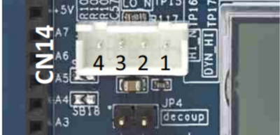

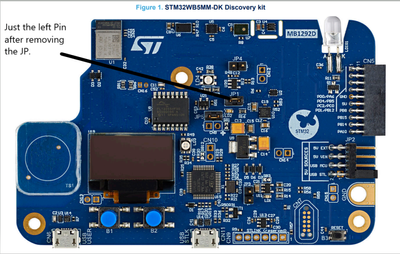

To connect the STM32WB5MM-DK to the X-Nucleo-lPM01A, you have to:
  • Remove the JP1 of the STM32WB5MM-DK.
  • Connect the Pin 1 of the CN14 of the X-Nucleo-lPM01A to a GND pin of the STM32WB5MM-DK.
  • Connect the Pin 3 of the CN14 of the X-Nucleo-lPM01A to the mentioned PIN (take a look at the second screenshot) on the JP1 of the STM32WB5MM-DK.
Is there an available pin or do I need to solder one?

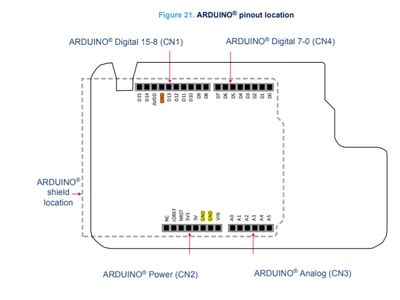

Hello @DS.4
There is GND pins on the Arduino connector:Screenshot_2024-03-20-13-22-37-90_e2d5b3f32b79de1d45acd1fad96fbb0f.jpg

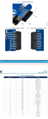

And also, on the ST Mod+ connector:
Best Regards.

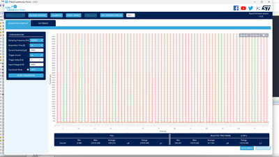

- only works with ST link  connected, otherwise its just show ~1mA constant
- I get this offset of 250uA when enters sleep ( I guess because of above?) , using BLE_HearRateFreeRtos example for P-NUCLEO-WB55
How can I power it from external source to validate?
Can I reach 3uA same as in P-NUCLEO-WB55
