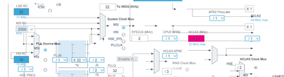

When I have configured MSI to 2MHz, the Sysclk became red and indicated clock issues, that's why I didn't know what to do...the voltage scaling range can be modified in the clock configuration ?

I just wanted to show my issue
