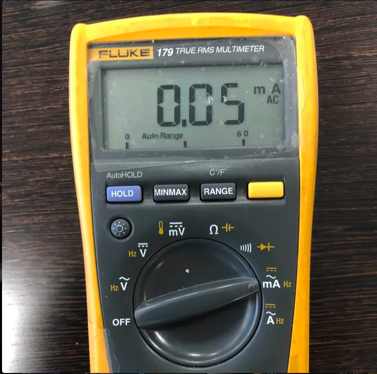

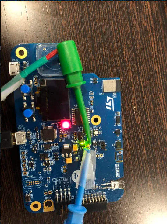

I want to measure the current consumption on a STM32WB5MMDK discovery board. I've found that I had to put an ammetre on the jumper JP1, and I programmed the RGB LED to be working. However, when I put the ammetre and I power my board, I found that the current is null, and I can't find why, even if I checked the schematics and the datasheets. I was supposed to have something around 100 mA normally.

2024-07-08 1:17 AM
your DMM is on AC ... :)
press function, to set DC measurement .

Show foto or read p14 Discovery kit with STM32WB5MMG module - User manual
2024-07-08 12:57 AM
Yes, that is what i have followed.
I am joining the pictures
