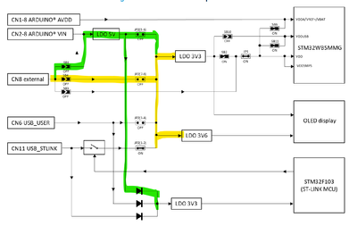

Hi, I developed an application using the stm32wb5mm-dk. Everything works until I try to use an external 5V power supply. In fact, I change the position of JP2 on position 7-8 (to select 5V EXT) and I soldered SB4. However, when I supply the board through CN8, LD2 is on, JP1 is at 3.3V but the application on the STM32WB seems not to being run. If I provide power also through the USB STLK, it seems to start running. Is there any other JP or SB to adjust for extenal 5V supply?
Thanks.
2024-12-19 5:36 AM
Yes, of course. I found a work around. Instead of using the yellow path, I follow the green one, which powers also the ST link. This works.
It seems that if the STLINK is not powered, it push the reset down. This can be a board design issue.

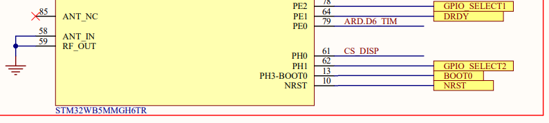

Hi, from the schematic (https://www.st.com/resource/en/schematic_pack/mb1292-wb5mm-d01-schematic.pdf) NRST is only connected to the STLINK and to the reset push button. No other information is given. Maybe is the STLINK (which is not powered) that pulls down the reset. Seems very strange
2024-12-19 5:29 AM
@matteverze wrote:NRST is only connected to the STLINK and to the reset push button.
Also to the NRST of the target:
2024-12-19 5:36 AM
Thanks
