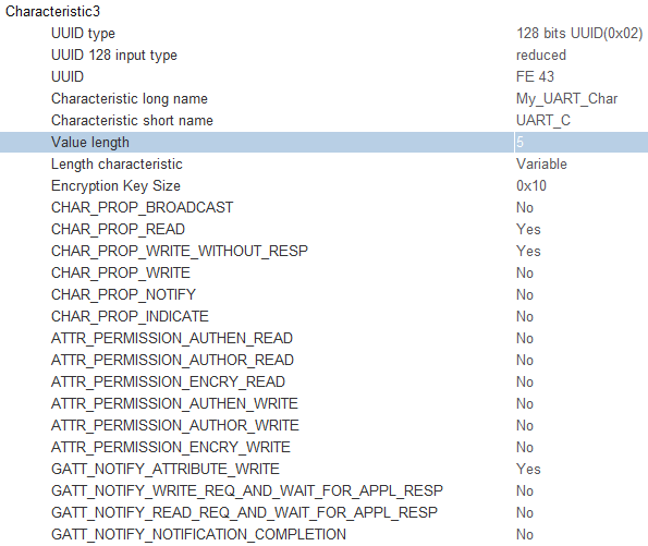

1. I made a new characteristic in CubeMX with a value length of 5 bytes and i set the length characteristic to variable because i want to send also less then 5 bytes:

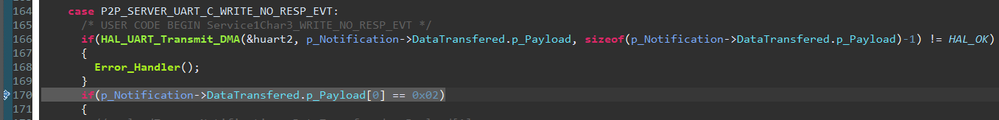

2. I started the debugger and set a brakepoint in p2p_server_app.c:
3. I checked the transmitted values in expression view:
Everything seems to be fine up to this point.
But when I try to send 3, 4 or 5 bytes, nothing happens and the program does not stop at the breakpoint. It seems that the change to 5 bytes was not reflected in CubeMX.
And when I look at the function aci_gatt_add_char() in the file p2p_server.c, I find here in the 4th argument SizeUart_C which has the value 2:

&(P2P_SERVER_Context.Uart_CCharHdle));Does the argument SizeUart_C define the length of the bytes? If so, then the CubeMX code generator generates an incorrect value here.
2024-12-19 4:42 AM
Hello @ledi001
Yes, the SizeUart_C is the Char_Value_Length. It means the Maximum length of the characteristic value. Using STM32CubeWBA V1.5.0, STM32CubeMX V6.13.0 and STM32CubeIDE V1.17.0 I've been able to create a characteristic with the size other than 2. So, it should work fine.
