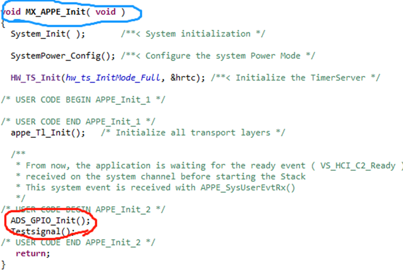

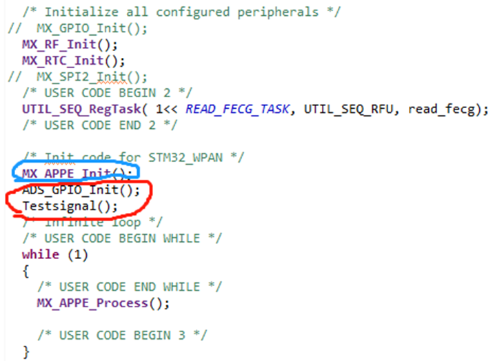

0693W00000Uo7EZQAZ.png0693W00000Uo7EeQAJ.pngI just moved the red circle part of Figure 1 to the position of the red circle in Figure 2, but I don't think anything has changed, but the program is fine. Can you tell me?
Thank you for your help. It's really a problem with my program.:beaming_face_with_smiling_eyes:
