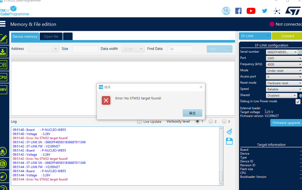

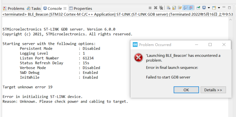

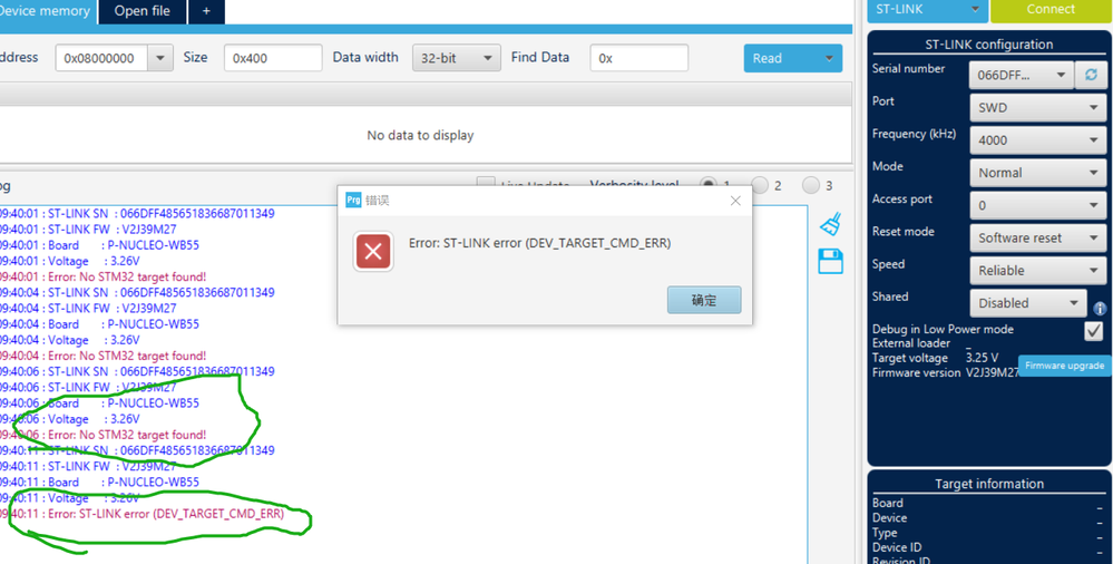

STM32WB55RGV6 (board P_NUCLEO_WB55) STM32cubeprogrammer errors show: first erro: No STM32 target found when i press button 'reset' error: ST_link erro(DEV_TARGET_CMD_ERR) stm32cubeide errors: error in launch sequence: Failed to startGDB server

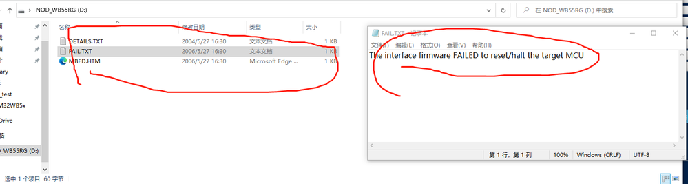

Note: I can use stlink to download programs to other boards.But p_nulceo_wb55 doesn't work well. I use an external stlink instead of the on-board stlink, the errors are same.
I was learning Bluetooth, It would have worked well. After a while, an error has occurred.
Is it because I have downloaded some program?
The errors are as follows(use stm32cubeprogrammer :(
0693W00000NpzZQQAZ.pngthe erros in stm32cubeide:

You can try to change the Mode to "Under reset" on STM32CubeProgrammer or press reset button SW4, keep SW4 pressed, click on Connect and release the button.

Thank you for your answer. The problems still exists. Once I pulled up boot0, I can connect the p_nucleo_wb55, but i can‘t read the flash and erase the flash,
, the error is 'Error: Mass erase operation failed.Please verify flash protection'. Later , the problem becom as mentioned above error ' no stm32 target found '.

Make sure that your STLink firmware is upgraded. Check pin configuration from the SWD connector. Can you try on another hardware?
If connect under reset doesn’t help, so probably the issue is related to power-supply configuration.

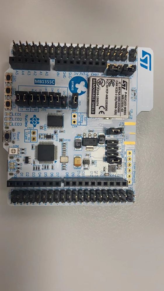

P_NUCLEO_WB55RGV6(MB1355C) :
  1. The st_link is on board and pin configuration is fixed.
  2. Another hardware can download ok.
  3. The power configuration is as picture shows , i check it many times.

Hi @�?� 丫饼​ ,
Make sure that you use the latest release of CubeProgrammer and CubeIDE.
I advise you this FAQ: How to solve debugger connection issues, it may helps you.
