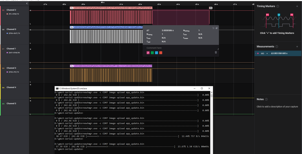

I am working on a project where the stm must act as a bridge between the PC and the device under test (DUT). We use the newtmgr tool on the PC to transfer/upload the firmware on the DUT via the stm at baudrate of 1MHz. For this, we are using two uarts on the stm i.e. USART1 connected to the PC and LPUART1 connected to the DUT. All packets received from the PC must be relayed to the DUT and all packets/responses received from the DUT must be forwarded to the PC.
I have attached the .ioc file that shows how I have configured the two uarts to be used with DMA's. I'd like the DMA's to work in the following cyclic order since it's a request-response mechanism.
With the above configuration, the transfer starts to work but stops after about 20%, as shown below image. You can also see on channel-2 i.e. (PC->STM), there's a massive delay of 3s introduced which could be breaking the upload process.
