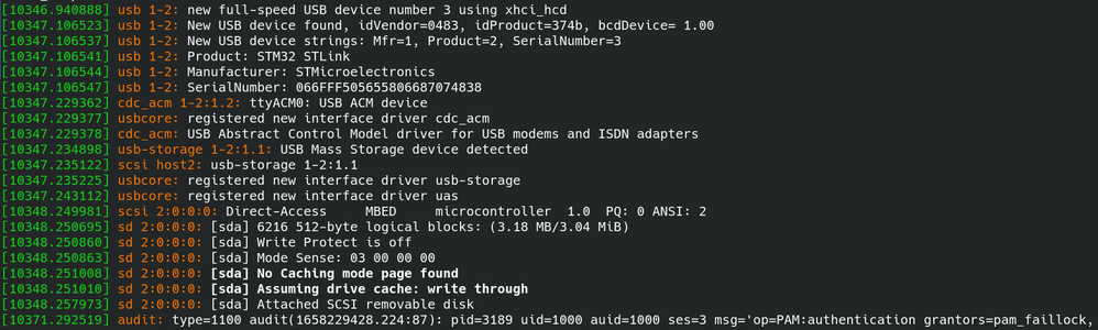

This is how my Linux recognize device:

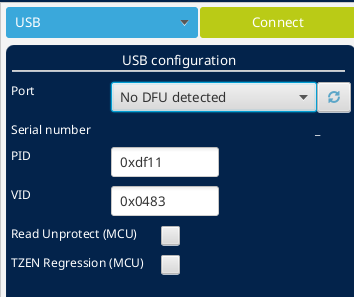

Jumpers are set up as you described. I can't connect by DFU:

2022-07-19 9:37 AM
Hi Remy,
I was able to connect with USB DFU mode however I don't know how to recover option bytes. Could you please tell me how to do that?
