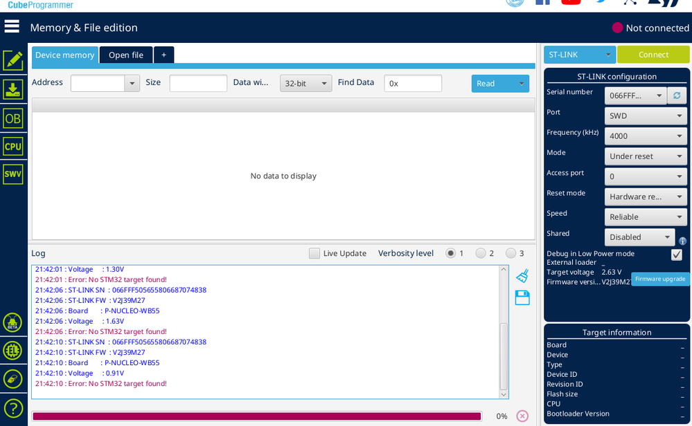

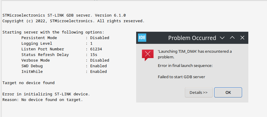

I have two P-Nucleo-WB boards and both of them end up in this state.
CubeIDE trying to load binary:

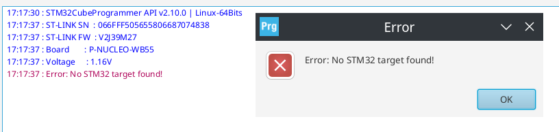

CubeProgrammer:
Found several topic that looks the same however nothing helped. Has anyone solved this problem?
2022-06-28 11:41 AM
Configure connect mode to Under reset
2022-06-28 12:47 PM
I have tried to connect it "Under reset mode" with pressed reset button. Result is the same:

Power comes from USB port and it's the same on other ports. Connecting under reset results in this same error. Is there any other method I could try to bring back my stm?
2022-07-01 3:49 AM
I have managed to run board in bootloader mode and successfully connect with CubeProgrammer through UART. I was able to load bin file. Unfortunately ST-link still does not work and I receive all the time this same error: "No device found". Any thoughts what else I can do?
