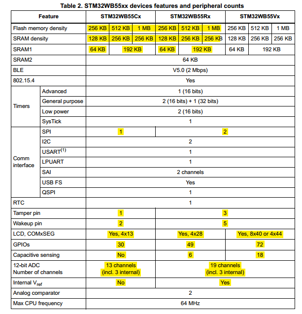

Hi all,
Could someone help me to clarify about the power consumption of STM32WB55CG, I can't see the difference between 2 series STM32WB55Cx and STM32WB55Rx related to "Low power modes". But in my case, I can put STM32WB55Rx (In Nucleo board) to Stop 2 mode with only 2.5uA consumption but it cost 60uA with the STM32WB55Cx once (USB dongle).

Resolved, I'm sorry I forgot to power the VDDRF pin !!
