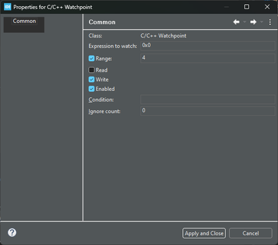

Thanks for the response. That explanation makes sense however, I put a watchpoint/data breakpoint at address 0x0 unlocked the flash and repeated the test but the breakpoint never gets hit. Am I missing something?
Since this issue is reproducible with the BLE_Ota example + FreeRTOS port (as per Seq_to_FreeRTOS_over_cmsis_os2.docx) perhaps your colleagues have encountered this specific issue?
