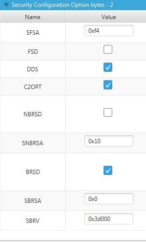

2021-12-25 12:39 PM
Hi!)
Has the issue been resolved?

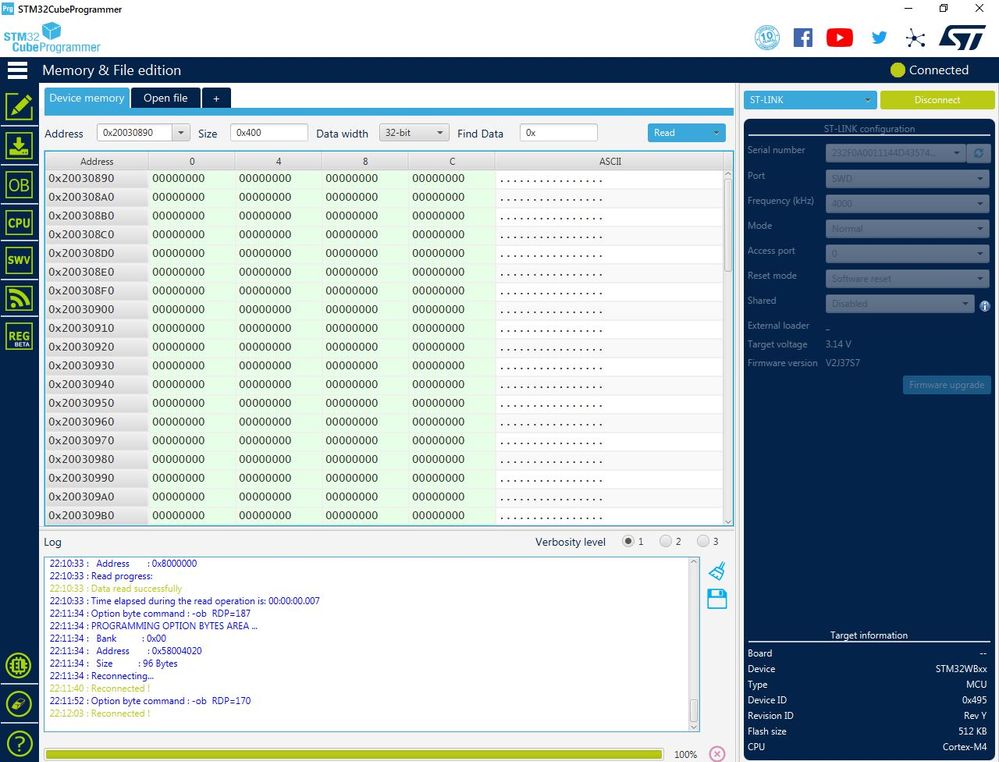

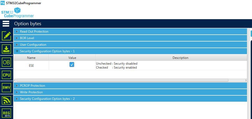

I have a similar problem. Previously, I successfully used WB55CGU6 (rev. Y) in my device, now I'm trying WB55CEU6 (rev. Y) (bought in June 2021 on Arrow.com ).
1. I tried to run on 5 boards in USB DFU mode - to no avail. I rechecked the OB combinations several times, physically pin BOOT0 to pull up to Vdd. The USB circuits actually work - I checked using a separate USB Mass Storage Device firmware.
2. When trying to work with FUS via SWD (of course at the changed addresses for CE), I get FUS_STATE_ERR_UNKNOWN errors.
3. Reading RAM at 0x20030890 gives all zeros.
Could these be "special" chips with damaged FUS?)
Help me) Thanks!

2022-01-14 10:15 AM
1. An attempt to read the status and version of FUS via SWD ends with the error FUS_STATE_ERR_UNKNOWN
At the same time, the data in the first flash sectors changes from 0xFF to some data.
2.I use the FW_WB V1.10.1 version
FUS version: first stm32wb5x_FUS_fw_1_0_2.bin, after - stm32wb5x_FUS_fw.bin from FW_WB V1.10.1. addr: 0x0807A000.
3.I tried USB DFU again - it doesn't work! Under the same conditions on WB55CG - everything is OK
4. I use BLUE_STACK_FULL, ~162kB
