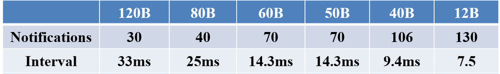

The following figure is the load and corresponding interval of my single notification:

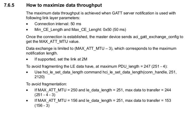

I think the interval is too long.I read AN5289 7.6.5 how to maximize data throughput, but I can't find the macro parameters Min_CE_Length and Max_CE_Lengtht, and I don't know where to insert these functions into the program.

You can manage the CE_Lenght parameter using aci_gap_start_connection_update command.
Best Regards
2022-11-07 5:24 PM
Thank you, in fact, I have tried these a long time ago, and it has never worked. What I found that finally got me success was I added this command: hci_le_set_Data_length();
