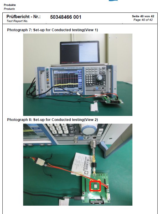

Nevertheless, I want to get new FCC ID for newly developed devices which is using STM32WB5MMG.
At photograph 8, the antena(or RF output)is connected to measurement equipment using some kind of connector, and it controlled by USB, I guess.
In conclusion, I would like to know the HW(like above photograph 8) and FW setting.
Sincerely.
2022-11-04 6:44 AM
I understand the picture demonstrated the test of another module and you would like to be able to do the same with the STM32WB5MMG module.
Why do you need to perform conducted tests? ... as the module is already FCC certified.
2022-11-06 5:11 PM
Hello.
Because, I want to get 'NEW FCC ID' to print it on the 'newly developed devices' to to attend CES.
2022-11-07 9:20 AM
You do not need to perform conducted test, radiated test are enough for the FCC when using a certified module on a board.
