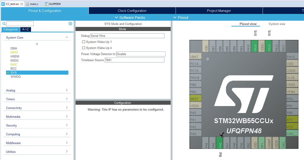

Stm32WB55CC with 1.8.0 pack has got the same problem. Systick is frozen. But solution from @Christophe Arnal not working... Also if I select Timebase Sourse = TIM1, program breaks somewhere in HAL_Init();

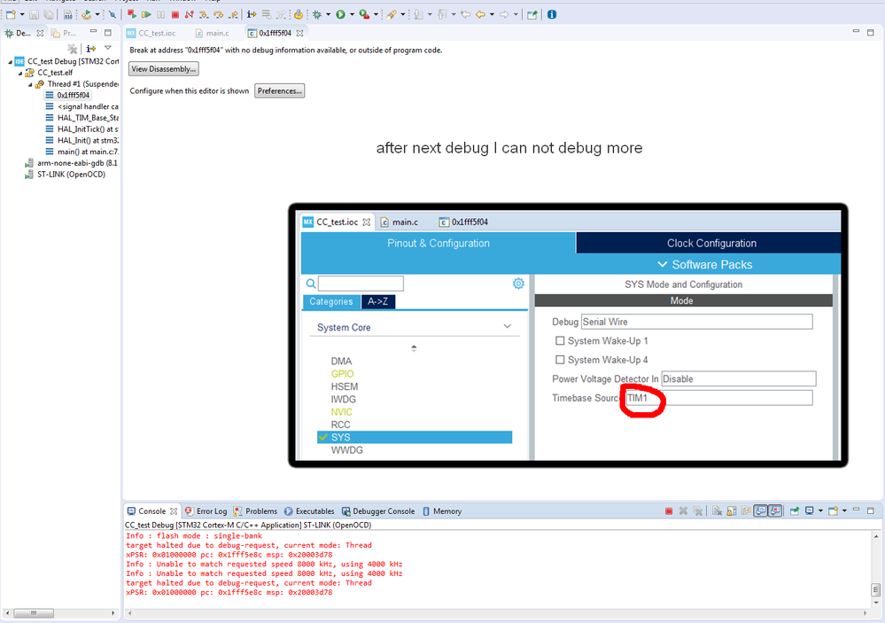

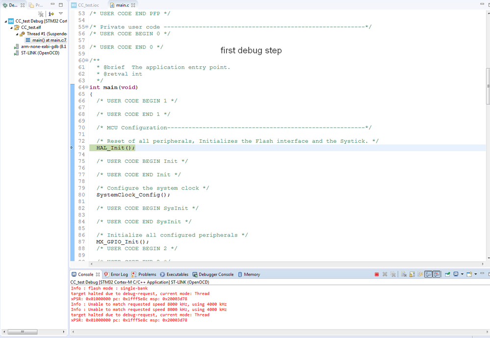

I generate new project for WB55CC in CubeIDE and try to do blink led:
I go to debug and do first step
I try to do second step, but prog going away.
This was "TIM1 problem". Next is about "Systick problem".

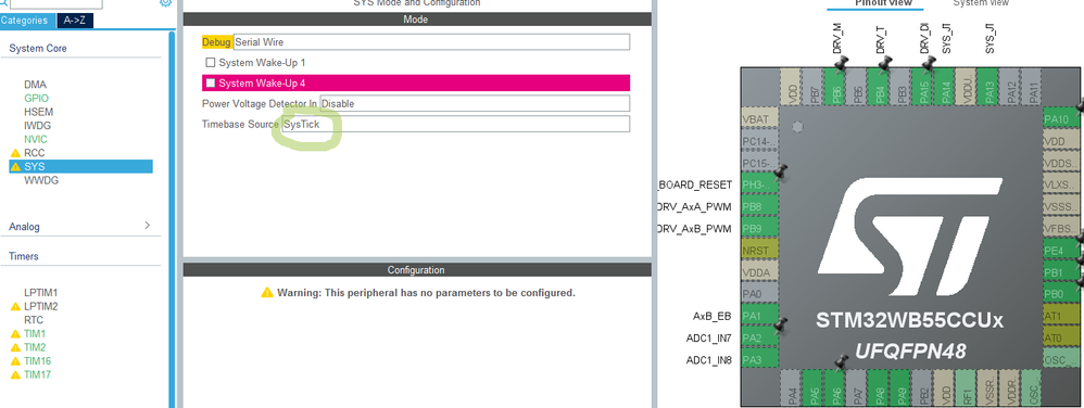

I select Timebase Sourse = SysTick, generate code. Debugger do all steps before while(1).

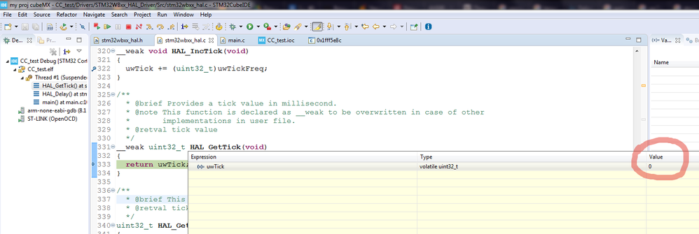

But after HAL_Delay(200) prog is infinity wating. I pause via debugger and I can see
Look at attachment.

I got systick problem! I use all timers and:
void SysTick_Handler(void)
/* USER CODE BEGIN SysTick_IRQn 0 */
/* USER CODE END SysTick_IRQn 0 */
CubeMX forgot HAL_IncTick();
/* USER CODE BEGIN SysTick_IRQn 1 */
/* USER CODE END SysTick_IRQn 1 */
The joke is that in project "CC_testSystick" 1.5MB above no this problem. I think this is because in proj above I use only one timer at one time.
