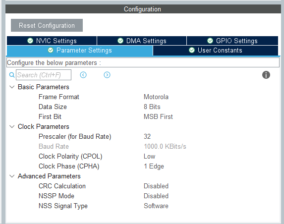

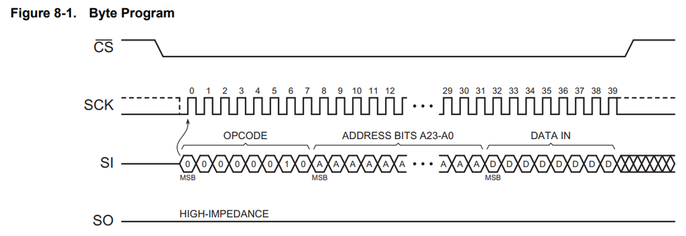

Here is an tutorial i used. The difference to my memory is the 24bit adress length.
2022-07-12 12:43 PM

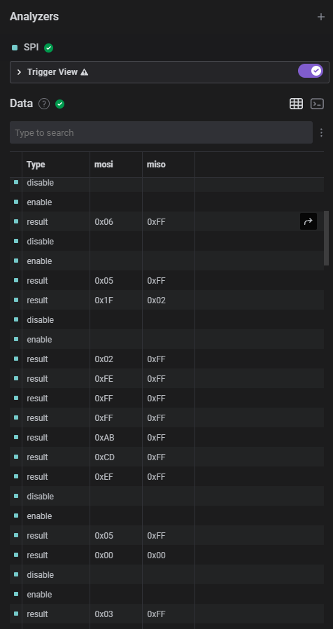

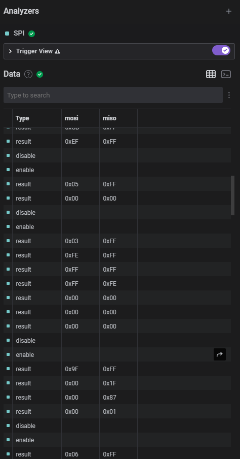

Probably need to make sure the transmit actually completes before releasing CS
Use the TransmitReceive form, push out dummy bytes where you need clocks, and discarding returned data where it's purely an output.
2022-07-13 12:32 AM
i inserted some HAL_Delay to wait after transmitting but this doesn´t helped.
Where is the difference between TransmitReceive and single use of Transmit and Receive?
The weird thing is it worked a few month ago. But the chip should be okay, because i can read the manufactor Id. Perhaps i accidentally changed some settings or its a timing problem.
The 24 bit used for the adress should be alright too. I first used the example vom digikey, but he used 8 bit for the adress what didnt work.
