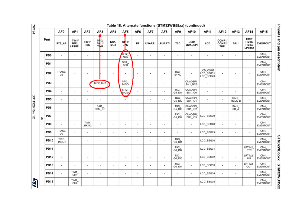

Which pins?
Look at the Alternate functions table in the datasheet to determine, which AF number to use for each pin.

Thank you,I found the error,SCK(PD1), GPIO_AF5_SPI2.
