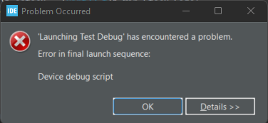

I was trying to use the time server for a project on STM32WB55. I tried to use it in an empty project. When I tried to debug, this window pops up:
The curious part of the problem is that this error seems to happen with the time cluster only: using another cluster such as the on/off one doesn't create any problem.
I will attach to this message the .ioc that I am using: I did not modify the STM32CubeMX output.
What can I do?
Thanks in advance.
P.S. Another thing I tried to do was removing and putting back single lines of code in order to understand which part of the program caused the problem. I figured out that the whole thing runs without encountering this specific problem when I remove this line:
/* file: app_zigbee.c */
zigbee_app_info.time_server_1 = ZbZclTimeServerAlloc(zigbee_app_info.zb, SW1_ENDPOINT, &TimeServerCallbacks_1, NULL);

2022-05-02 10:28 AM
I looked for the two defines you gave me in my code and they were already set to the right values. I did not find an already-made example with the time cluster for my microcontroller, that's why I tried to generate code with STM32CubeMX and compile it without adding anything.
I know that those lines are needed, I just tried to isolate the cause of the probem. From what I saw it seems like the TimeServerAlloc is "incompatible" with the debugger (the application seems to work if I just flash it with the programmer and let it run)
