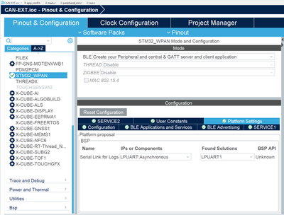

Hello @cvs_dk
To solve this issue, you need to set an (LP)UART interface for Serial Link:
Best Regards.
