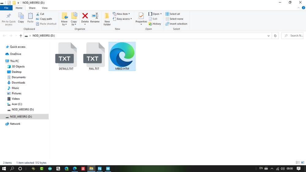

When i connect the STM32WB55 with PC via USB cable on ST-Link Port,

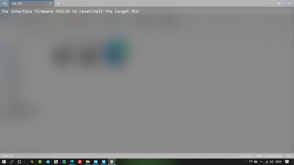

This window is prompted on my screen with Fail.TXT file showing message as shown in PIC
what can be the reason and issue?

Well yeah above problem was coming because i have not connected the connectors on Jumper 3, so My MCU is not getting Powered from power supply thus it is getting error like this
