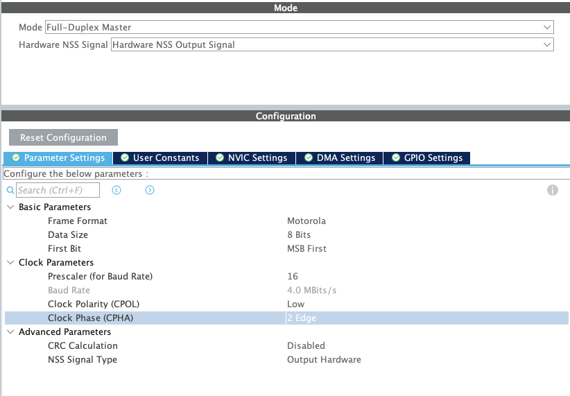

We're trying to use the spi in mode 0 (CPOL=0 CPHA=0) , but we can't make it work.
We have these settings:
and our code looks like this

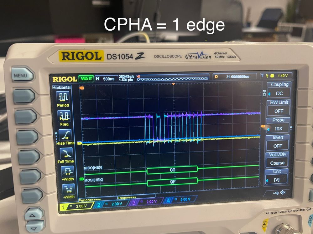

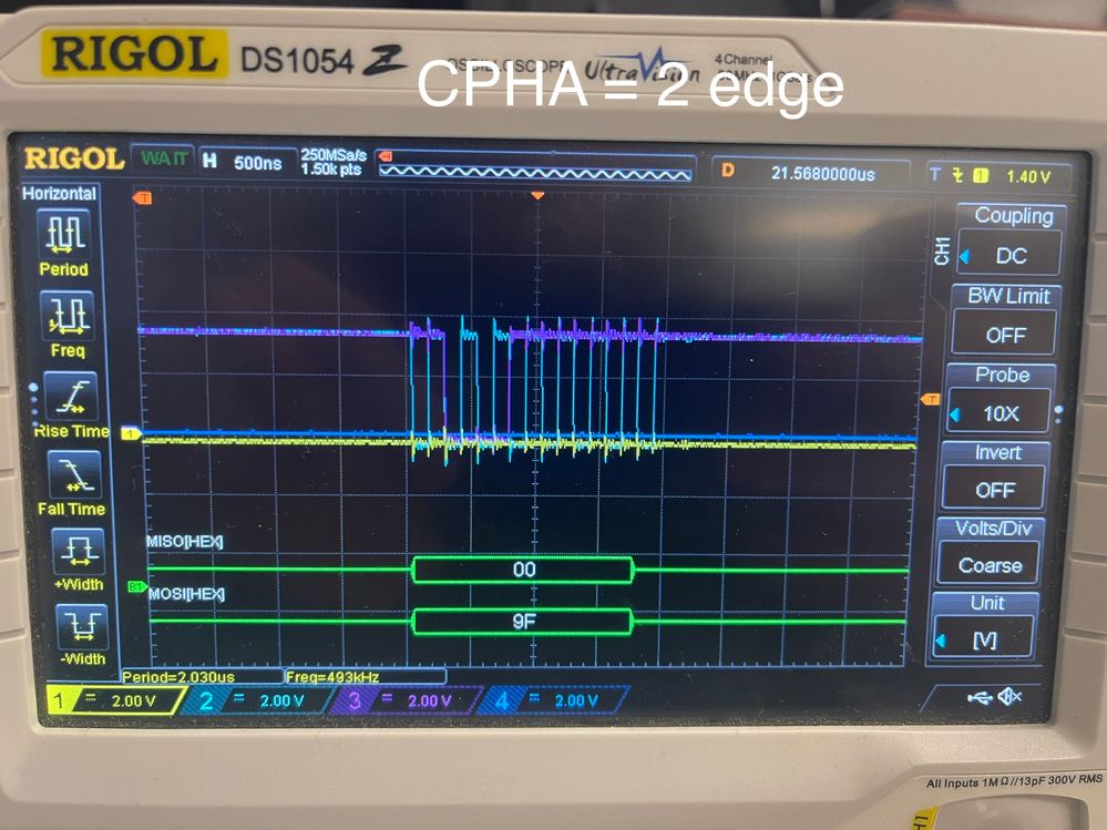

}And no matter if we set CPHA = 1 edge or CPHA = 2 edge the SPI signal is the same
We tried the same test on a Nucleo Wb55Rg and we had the expected result but not on our custom board.
Is there anything software or hardware we miss to acheive spi mode 0 ?
