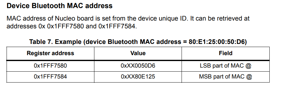

Hello folks. How can I determine the BLE MAC address of my WB55 device's wireless stack?

it can be read from a register below.
Best regards,
Filip Kremen
