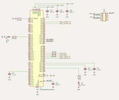

Hi, but I got a new set of PCBs fabricated, and also with other boards and all the WB5s fail.
yes I can program and debug any other STMs, for example the H7 on the same board is working fine, also I bought the Datalink V3 to try and it does not work.
Here I attach the schematic.

Are all of your VSS pins connected? Only one is shown in the schematic.

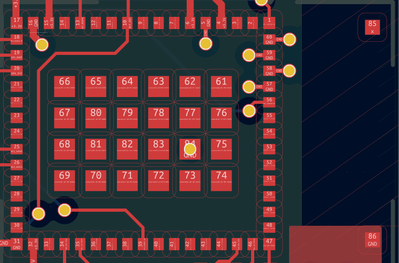

this is the actual layout:
Thank you!
