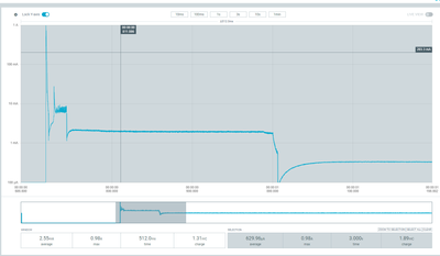

but when I try on my own app it goes direct in stop2 mode and I've no advertising and no connection

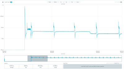

it works like a charm except obviously it don't go to stop mode but advertising and connection are working

Ive try different things I have also try debugging with my own prinf like calls and it looks it goes directly in stop but best way to show you is with current consumption
Stop mode Enable
Stop Mode disable (we well see spikes of adverting frames)
