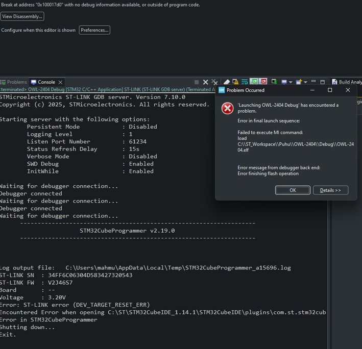

Hi, I use stm32wb09 microcontroller to build a project. Whenever I try to program from cubeIDE with stlink, I encounter with this given error on photo. With open OCD debugger selection I can program the microcontroller, but I want to program with my stlink since open ocd debugger kinda freaks out when debugging. I used both stlink v2 or v3 and updated to latest versions. I can program different mcu's but when it comes to stm32wb09 one it always gives this error. I also can program with the help of stm32 programmer by downloading hex file but to debug properly I need to program with stlink. Is there any particular reason that might make happen this error, or is it a known error for stm32wb09 mcu?

I had the same issue, I solved it using the ST-Link v3 mini and connecting the rst pin of the ST-Link with the pin 29 of the microcontroler.
Now I have problems debugging my code, my firmware runs during a time and then it's like the ST-Link disconnects

Are you using your own design based on the STM32WB09 or the NUCLEO evaluation board. If it is the Nucleo board, I think the Note under paragraph 7.12 of the UM3345 Rev 1.should help you.
