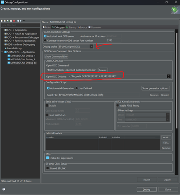

2025-01-08 4:14 AM
Hi All,
While ST sort out the bug reported in this thread. In the meanwhile as a work around we can use OpenOCD as a debugger and connect to multiple boards using the following steps outline below.
2025-01-08 5:32 AM - edited 2025-01-08 6:54 AM
