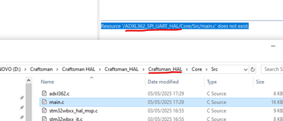

I renamed a project in CubeIDE but now I'm trying to open the project I get resurce does not exist even though I can clearly see it existing!
What's the story here?

Looks like the directory name is different.
Double click on the project in the Project Explorer to open it.
Hover over the "main.c" tab to see the location it's trying to open. Probably it's the same as the error message.
