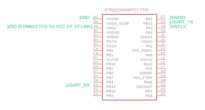

Could you please share the schematics of your board and the connection with your ST-LINK.
Best Regards.
STTwo-32
2025-01-10 7:39 AM - edited 2025-01-10 7:44 AM
This is all I can share. Unfortunately, I'm not suing RST (B5) pin of this microcontroller.
2025-01-10 8:11 AM
This is the same behavior mentioned on the previous link. The RSTN pin should be linked to the NRST pin of your ST-LINK.
Best Regards.
STTwo-32
2025-01-10 1:06 PM
I can try but I cannot understand because it wasn't mandatory when I used the STM32WB55 microcontroller.
2025-01-11 2:43 AM
Thanks. Now IDE is working now by connecting NRST to RST.
2025-01-11 2:56 AM
@KKIM.6 wrote:I cannot understand because it wasn't mandatory when I used the STM32WB55 microcontroller.
Indeed, NRST isn't generally needed, but there are cases where it is necessary - particularly where the application goes to sleep and/or disables the debug pins.
This is why it's always good to include access to NRST in your debug/programming connection.
