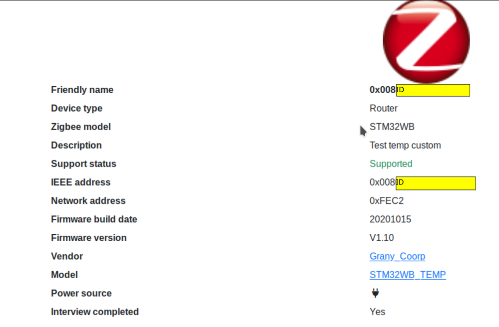

I have ran and modified few examples of applications for Zigbee on Nucleo STM32WB.
I have registered my STM32WB as a node of my existing Zigbee network and it works fine.
My coordinator indicates me that the Zigbee model of the node is "STM32WB".
I guess it is the node that somehow annonced his model. Is it possible to change this model name to put a custom name instead?
Thank you for your answer,
Best regards,
Léo
PS: is there a complete documentation of the API/stack available where I can find that kind of information?

I have made some progress on the matter. �?�?
I have found this structure in zigbee.h to change all the settings I want, including model name:
struct ZbZclBasicServerDefaults {
uint8_t app_version; /**< ZCL_BASIC_ATTR_APP_VERSION */
uint8_t stack_version; /**< ZCL_BASIC_ATTR_STACK_VERSION */
uint8_t hw_version; /**< ZCL_BASIC_ATTR_HARDWARE_VERSION */
uint8_t mfr_name[ZCL_BASIC_MANUFACTURER_NAME_LENGTH + 1U]; /**< ZCL_BASIC_ATTR_MFR_NAME (First byte length) */
uint8_t model_name[ZCL_BASIC_MODEL_IDENTIFIER_LENGTH + 1U]; /**< ZCL_BASIC_ATTR_MODEL_NAME (First byte length) */
uint8_t date_code[ZCL_BASIC_DATE_CODE_LENGTH + 1U]; /**< ZCL_BASIC_ATTR_DATE_CODE (First byte length) */
uint8_t power_source; /**< ZCL_BASIC_ATTR_POWER_SOURCE (e.g. ZCL_BASIC_POWER_UNKNOWN) */
uint8_t sw_build_id[ZCL_BASIC_SW_BUILD_ID_LENGTH + 1U]; /**< ZCL_BASIC_ATTR_SW_BUILD_ID (First byte length) */
};I have tried to use it in app_zigbee.c as following:
static void APP_ZIGBEE_StackLayersInit(void)
APP_DBG("APP_ZIGBEE_StackLayersInit");
zigbee_app_info.zb = ZbInit(0U, NULL, NULL);
assert(zigbee_app_info.zb != NULL);
defaultCustom.app_version = 0;
defaultCustom.stack_version = 10;
defaultCustom.hw_version = 0;
memcpy(defaultCustom.mfr_name, "Granyy", sizeof("Granyy")-1);
memcpy(defaultCustom.model_name, "TEMP1234", sizeof("TEMP1234")-1);
memcpy(defaultCustom.date_code, "26020221", sizeof("26022021")-1);
defaultCustom.power_source = ZCL_BASIC_POWER_BATTERY;
memcpy(defaultCustom.sw_build_id, "26020221", sizeof("26022021")-1);
ZbZclBasicServerConfigDefaults(zigbee_app_info.zb, &defaultCustom);
/* Create the endpoint and cluster(s) */
APP_ZIGBEE_ConfigEndpoints();
}Now my coordinator does not recognize or display model name as wanted. It seems to be empty (' ' ).
I have noticed that there is a function called: zb_hex_str_to_bin. I have tried to call it to transform my strings in Zigbee readable data (maybe I need to do that?). The function does not seem to be defined so I got a build error.
Can you help me? How can I use this structure properly?
