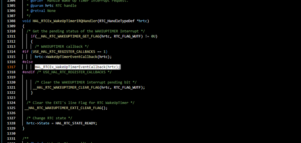

The problem was seen in a real application.
I understand. I believe then the actual problem was then in the use of the timerserver code.
The HW_TS_RTC_Wakeup_Handler was called from the HAL_RTCEx_WakeUpTimerEventCallback method which as can be seen below is before the clearing of the WUT flags.
Remi QUINTIN
OK. So let's consider this case as closed

Remi QUINTIN
Going a bit deeper in this issue
It seems you are using HAL_RTCEx_WakeUpTimerIRQHandler from the NVIC which in turn call HAL_RTCEx_WakeUpTimerEventCallback.
However,
1/ This API was overrule
#define HAL_RTCEx_WakeUpTimerIRQHandler(...) HW_TS_RTC_Wakeup_Handler( )
So HAL_RTCEx_WakeUpTimerEventCallback shall be never called.
2/ even though HAL_RTCEx_WakeUpTimerEventCallback, it is not sure it will call in turn HW_TS_RTC_Wakeup_Handler(). I dont think there is any link.
Anyway, best is to make sure HW_TS_RTC_Wakeup_Handler() is the only handler called from the NVIC. Either directly or with the macro renaming from app_conf.h.
in all cases, HAL_RTCEx_WakeUpTimerIRQHandler shall be never entered.
