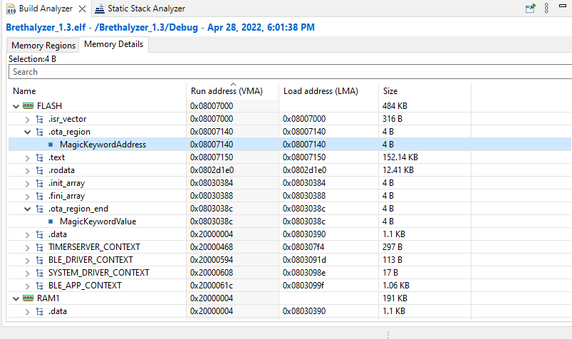

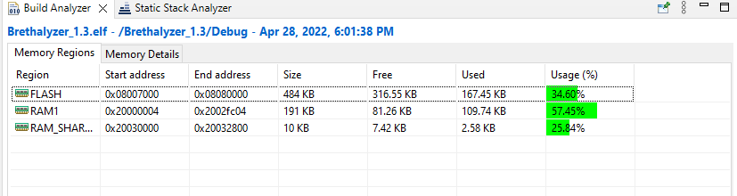

For the reference, here I have attached the linker script, Memory region & memory details screenshot
I'm using the Wireless FW version: 1.13.2 and FUS version: 1.2.0

FLASH (rx) : ORIGIN = 0x08007000, LENGTH = 484k
RAM1 (xrw) : ORIGIN = 0x20000004, LENGTH = 191k
RAM_SHARED (xrw) : ORIGIN = 0x20030000, LENGTH = 10K

.ota_region 0x08007140:
KEEP(*(TAG_OTA_START))
. = ALIGN(4);
} >FLASH

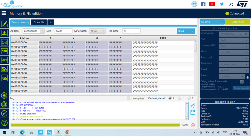

2022-04-30 1:22 AM
Hi.. community
here is one more input
When I try to read the Flash memory from 0x08007000 after the OTA update cycle, its shows the empty flash at all
Thanks

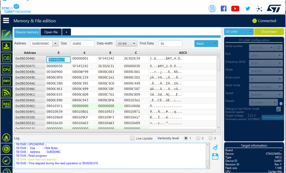

2022-05-04 9:23 AM
Can you check if the magic keyword is equal to 0x94448A29 in your app ?
Best Regards
2022-05-05 5:53 AM
Hi... @Remy ISSALYS
Thanks for your reply,
Yes, 0x08007140 is the address at where, Magic No. address is stored
I have read that address from the Cube programmer, and verified that the magic No is stored there
have a look at the cube programmer screenshot
Thanks
Mahendra

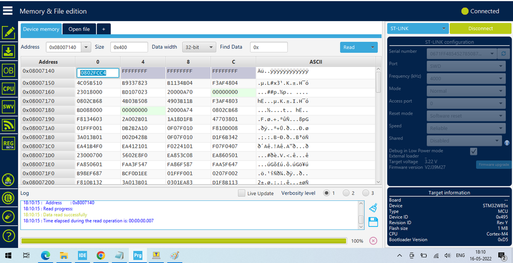

I have just set the break points as per the reference video, and I got to know that, it is the issue with the Magic No address. verification
When i send the reboot request for the OTA update from the app then, i can check the value of the CFG_OTA_REBOOT_VAL_MSG set to 1, which is as expected
Where as Magic No address seems odd, than what I'm getting from my custom application
here, i have attached the screenshot from my custom app with using the cube programmer
As you can see from the above two screenshot

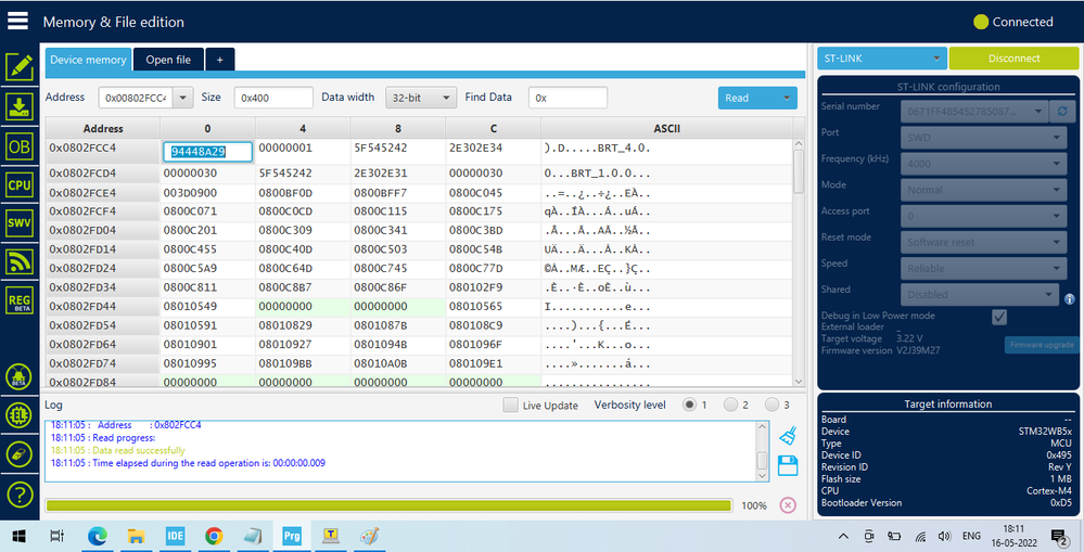

0x08007140 is the address at where the address of the magic no stored, which is 0x802Fcc4
In a second screenshot, you can see that at the address 0x802Fcc4 the magic no lies, which is 0x9448A29, which is as expected!

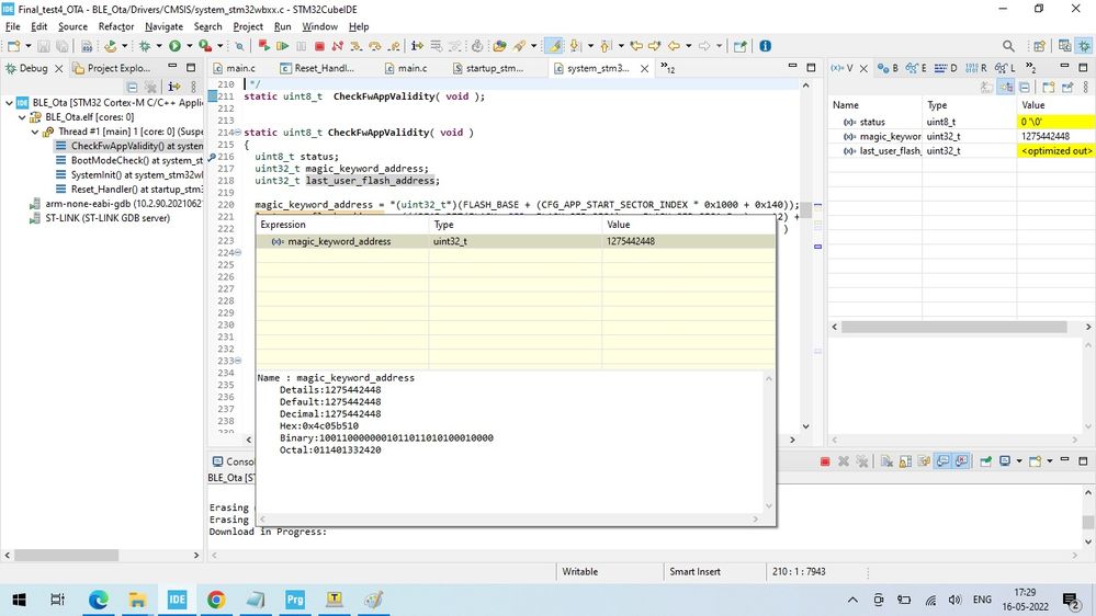

Now here the what i got after reboot at OTA loader app
The magic no. address seems 0x4c05b510 which is odd!
And that's how the magic no. address verification is failed
