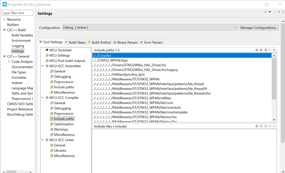

Hello, I created a new project with STM32WB. I try to build a project but receive many errors for drivers. If I correctly understand I need to install drivers separately from - STM32Cube_FW_WB_V1.14.0?
2022-10-19 12:37 AM
Maybe, you are missing some include paths in project settings, see the following screenshot:
Best Regards
