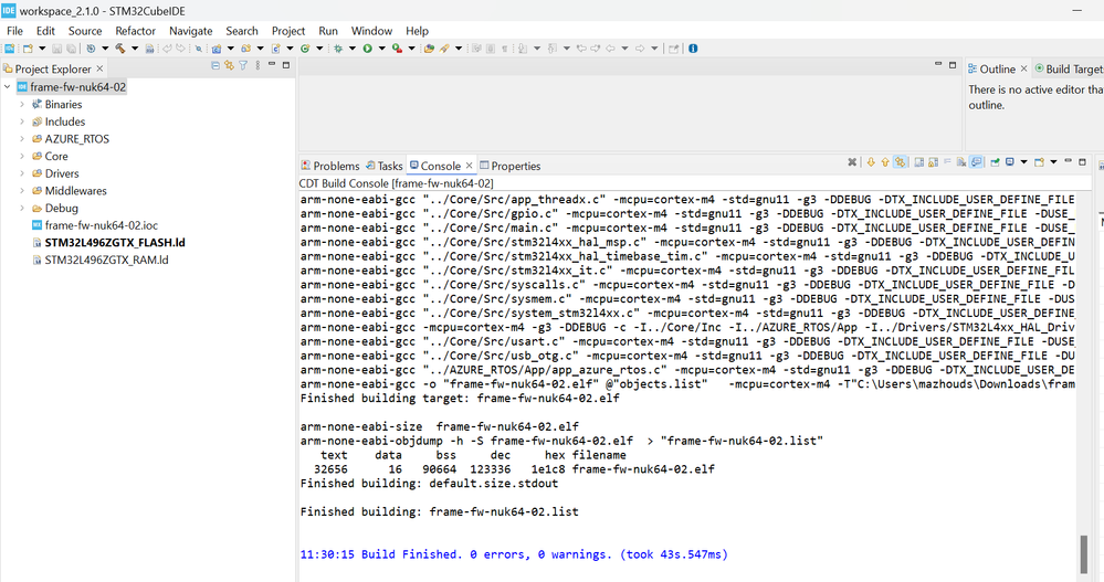

Using your ioc and building with STM32CubeIDE 2.1.0, I was not able to reproduce the issue:
KR, Souhaib
