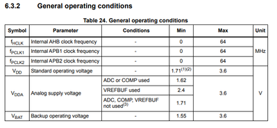

According to the Table 24 of the DS11929, the internal APB2 clock frequency can take any value between 0 and 64MHz:
PS: you can take a look at the clock configuration of the examples that are using the same board. you will find that the APB2 can take different values (not more than 48Mhz).
