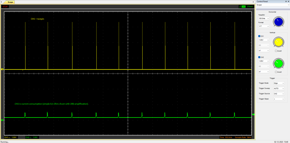

If I go to the file stm32_lpm_if.c and edit:
static void EnterLowPower(void)
* This function is called from CRITICAL SECTION
HAL_GPIO_WritePin(testpin_GPIO_Port, testpin_Pin, 0);
and
static void ExitLowPower(void)
HAL_GPIO_WritePin(testpin_GPIO_Port, testpin_Pin, 1);
/* Release ENTRY_STOP_MODE semaphore */
then I can see that each 100 ms (advertising interval), the microcontroller wakes up (current spike and test pin goes high)
and then goes back to sleep (test pin goes low).

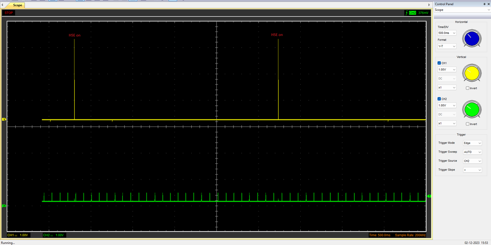

static void Switch_On_HSI(void)
and here
LL_HSEM_ReleaseLock(HSEM, CFG_HW_ENTRY_STOP_MODE_SEMID, 0);
while(LL_HSEM_1StepLock(HSEM, CFG_HW_RCC_SEMID));
if(LL_RCC_GetSysClkSource() == LL_RCC_SYS_CLKSOURCE_STATUS_HSI)
/* Restore the clock configuration of the application in this user section */
/* USER CODE BEGIN ExitLowPower_1 */
LL_RCC_HSE_Enable( );
__HAL_FLASH_SET_LATENCY(FLASH_LATENCY_1);
while(!LL_RCC_HSE_IsReady( ));
LL_RCC_SetSysClkSource(LL_RCC_SYS_CLKSOURCE_HSE);
while (LL_RCC_GetSysClkSource( ) != LL_RCC_SYS_CLKSOURCE_STATUS_HSE);
/* USER CODE END ExitLowPower_1 */
then I observe, that the HSE is only turned on each 2,4 seconds.

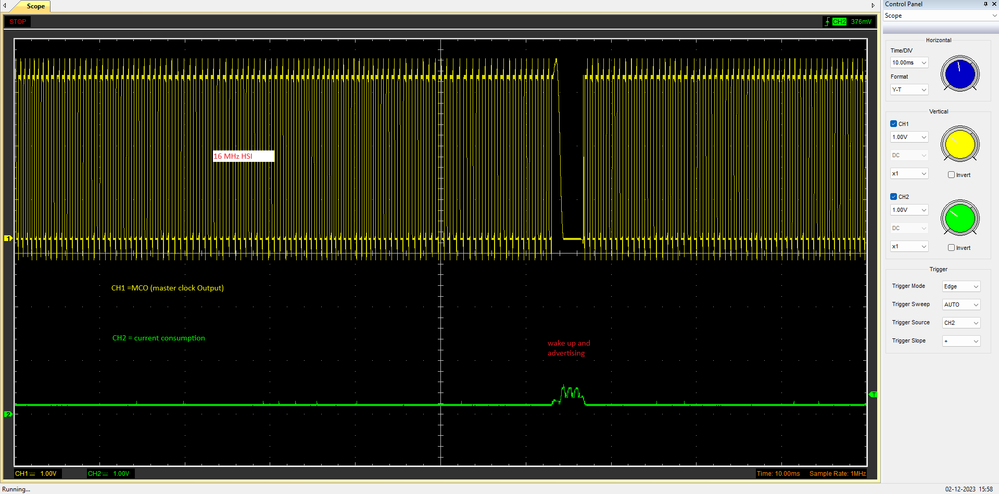

From the readings on the oscilloscope, I cannot confirm that the HSE is turned on each 100 ms, as I would suppose it would be.
Also, when I monitor the MCO output (I output the HSE to a pin), it shows the HSI clock during sleep, but during the advertising there seems to be no clock signal on MCO pin (with prescaler = 16).

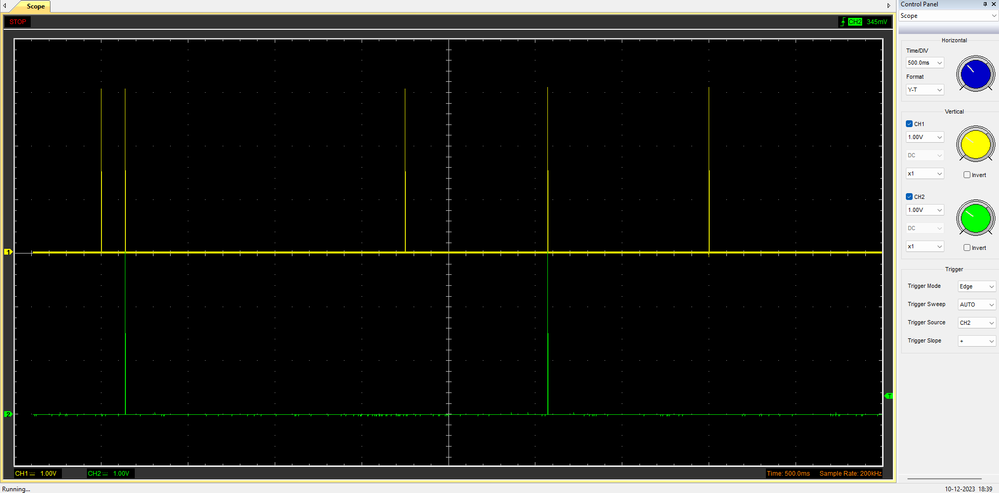

2023-12-10 10:02 AM
Here´s a test with an oscilloscope:
Channel 1 (yellow) shows a spike each time the HSI is started.
Channel 2 (green) shows a spike each time the HSE is started.
Advertising interval is ~1,7 s. A software timer triggers a task each 2,5 s.
You can clearly see, that during advertising, there is no spike for the HSE, only for the HSI.
For the task, however, first there is a spike for the HSE (microcontroller wakes up and executes a task), directly followed by the activation of the HSI (for sleep).
I can observe this behavior with and without the debugger connected.

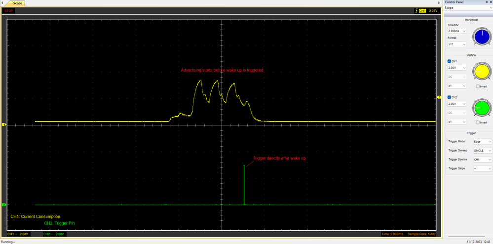

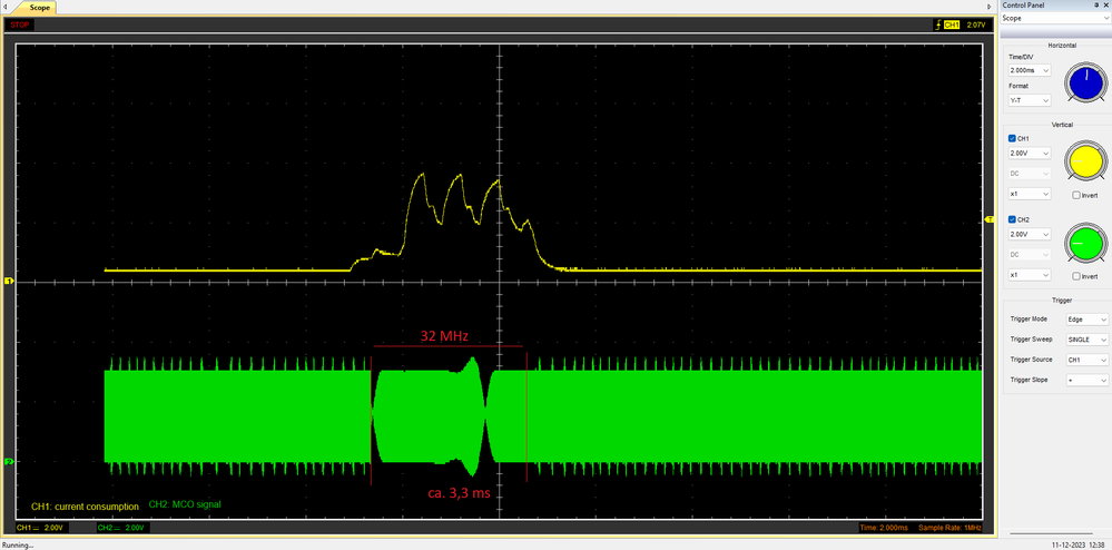

2023-12-11 4:06 AM
Ok, I did some more testing.
I think I observed that the HSE is activated before CPU1 wakes up from sleep mode.
CPU1 does wake up from sleep mode after advertising.
I set a test pin (LED_FLASH) high and low directly after _WFI(), so I can see when the microcontroller wakes up.
void PWR_EnterStopMode(void)
/* USER CODE BEGIN PWR_EnterStopMode_1 */
/* USER CODE END PWR_EnterStopMode_1 */
* When HAL_DBGMCU_EnableDBGStopMode() is called to keep the debugger active in Stop Mode,
* the systick shall be disabled otherwise the cpu may crash when moving out from stop mode
* When in production, the HAL_DBGMCU_EnableDBGStopMode() is not called so that the device can reach best power consumption
* However, the systick should be disabled anyway to avoid the case when it is about to expire at the same time the device enters
* stop mode (this will abort the Stop Mode entry).
HAL_SuspendTick();
EnterLowPower();
* ENTER STOP MODE
LL_PWR_SetPowerMode(LL_PWR_MODE_STOP2);
LL_LPM_EnableDeepSleep(); /**< Set SLEEPDEEP bit of Cortex System Control Register */
* This option is used to ensure that store operations are completed
#if defined (__CC_ARM)
__force_stores();
#endif
// LED_FLASH_GPIO_Port->BRR = (uint32_t)LED_FLASH_Pin;
__WFI();
/* USER CODE BEGIN PWR_EnterStopMode_2 */
LED_FLASH_GPIO_Port->BSRR = (uint32_t)LED_FLASH_Pin;
for(uint32_t i; i<32; i++)
__asm__("nop");
/* USER CODE END PWR_EnterStopMode_2 */
return;
}I also measured the current consumption, so I can see when the microcontroller is advertising.
Interesting to see is that the microcontroller seems to stars advertising before CPU1 wakes up.

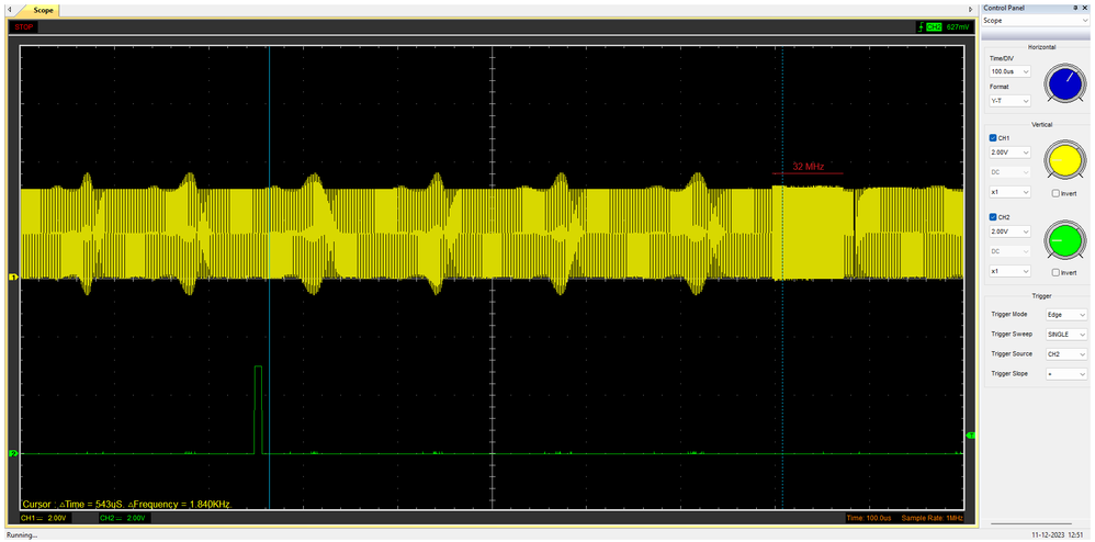

I also connected CH1 to the MCO to observe the clock change:
How does it do that? I thought the HSE is "actuated" by the CPU1? Here we clearly see, that the HSE is running before CPU1 wakes up, which confirms my findings from previous posts.
If I wake up the microcontroller with a timer task, then it first wakes up and then starts the HSE:
