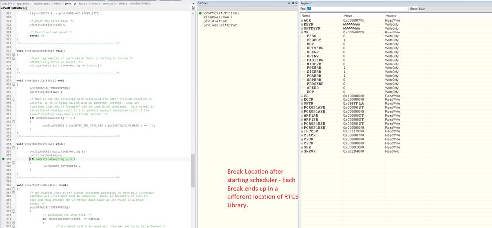

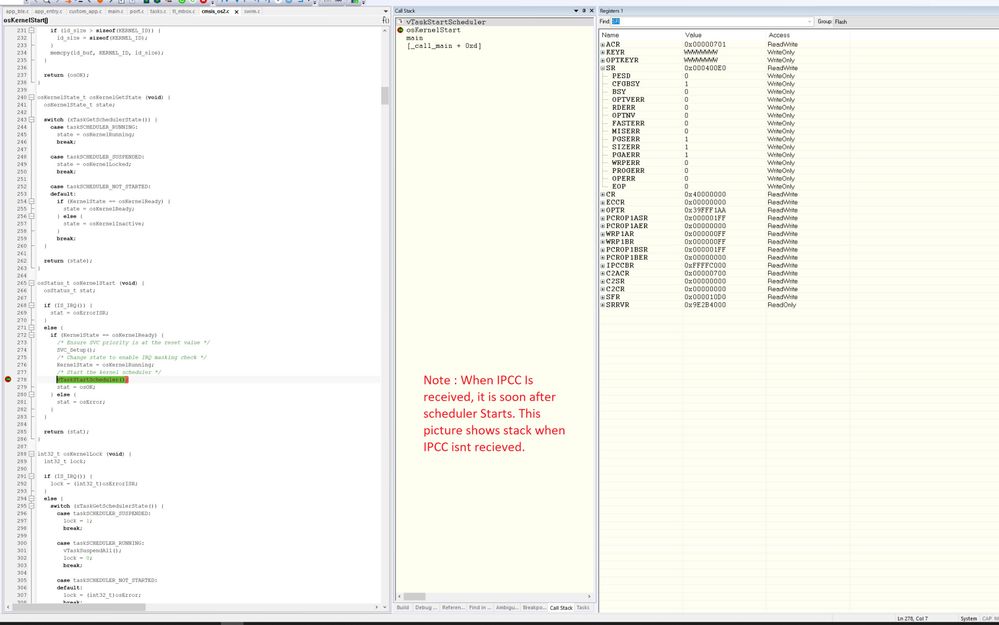

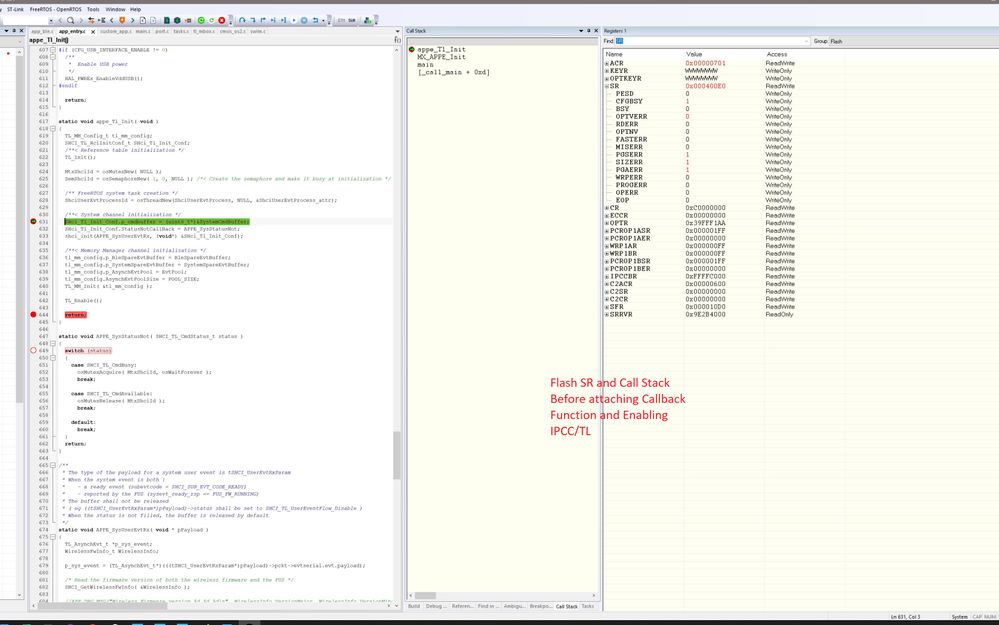

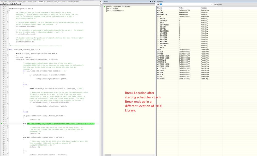

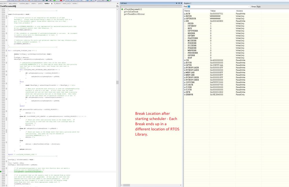

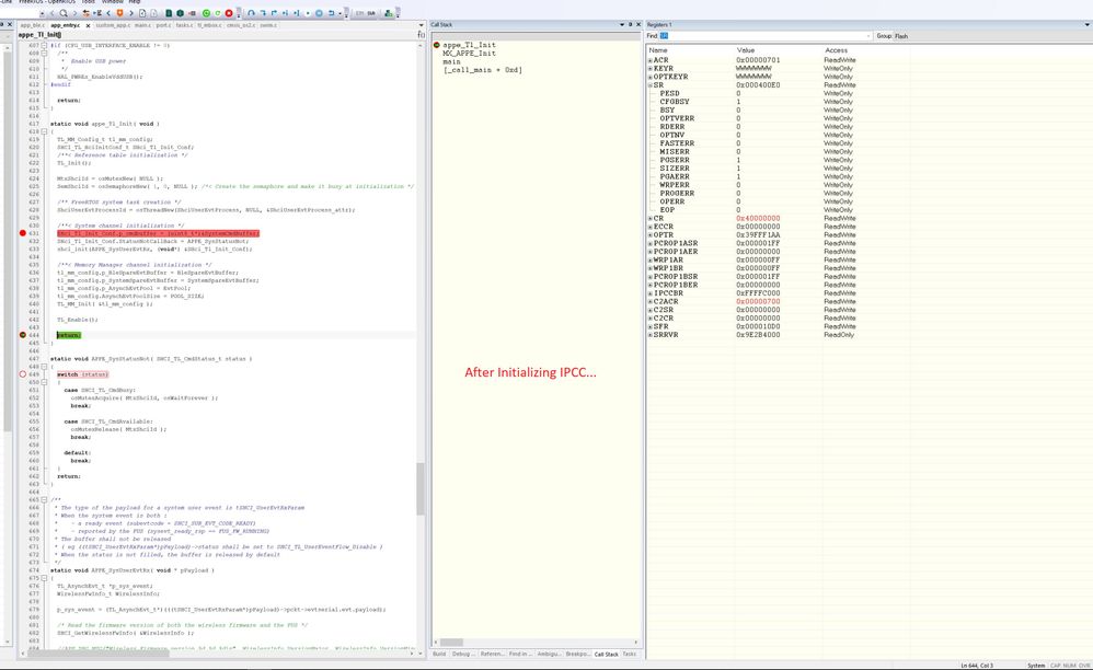

2022-04-12 2:46 PM
Screenshots shows the Flash Status Bytes before callback is attached, and after IPCC is initialized =>
Screenshots shows where the CPU is Spending its time When IPCC is Expected..
Thanks

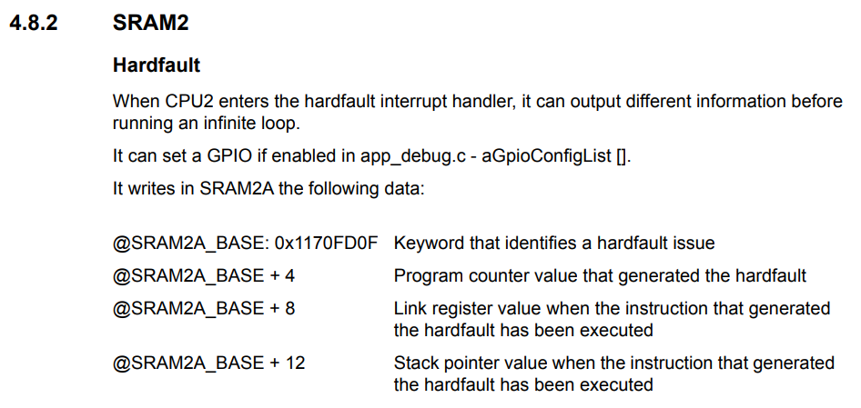

2022-04-13 2:20 AM
Thanks for your answer.
At the address 0x20030000, you have the hardfault keyword according to AN5289:
And with flash register, we can see that flash is in error maybe causes by writing data at address 0x00000000 of the flash (e.g null pointer).

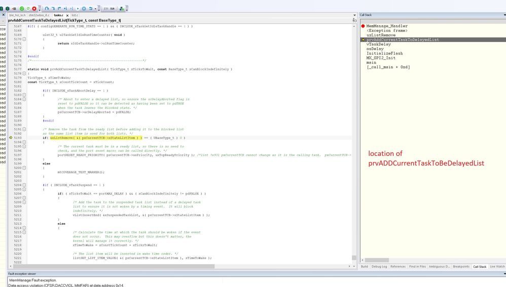

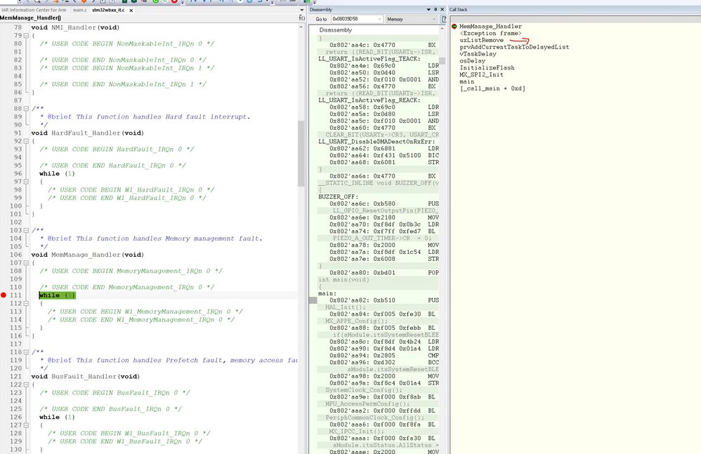

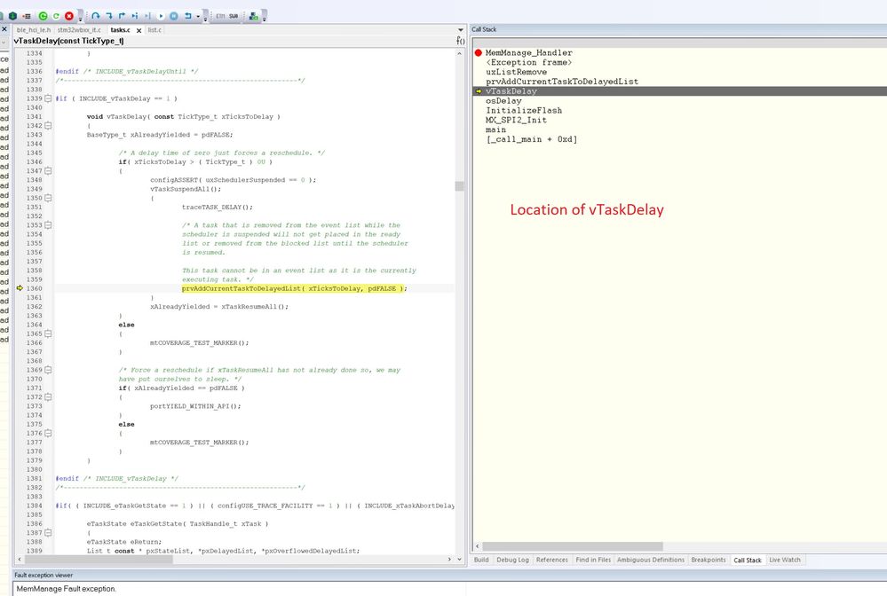

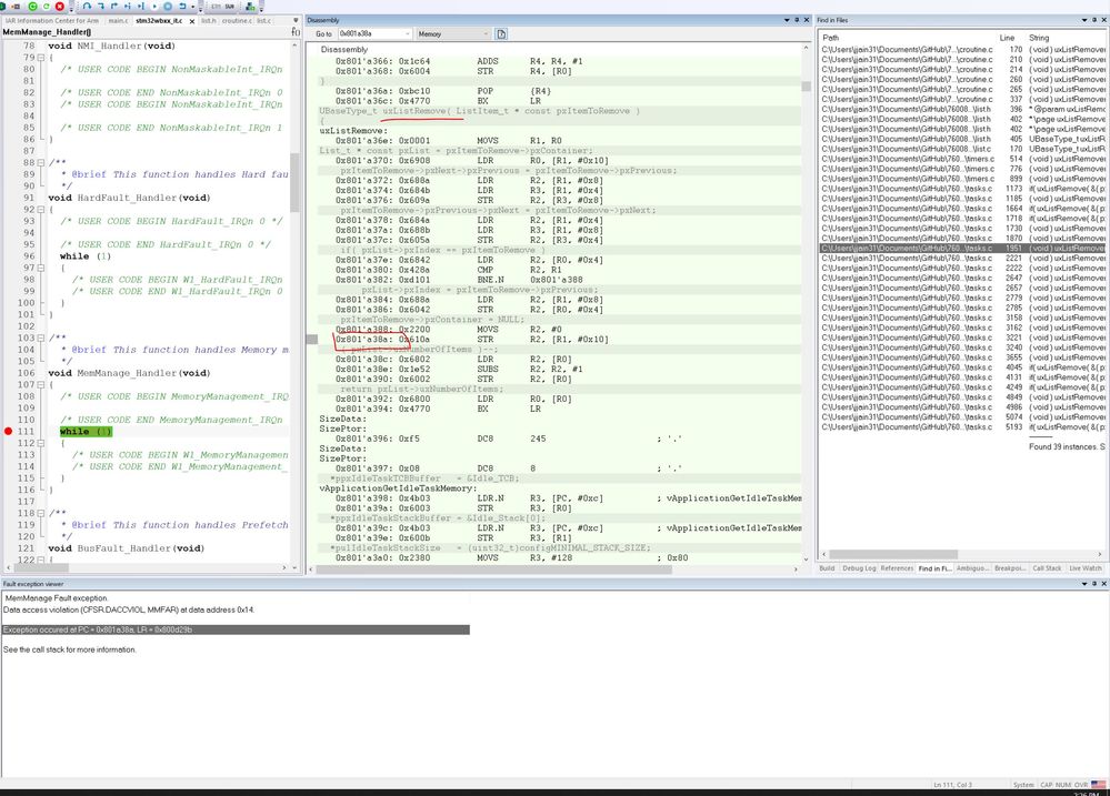

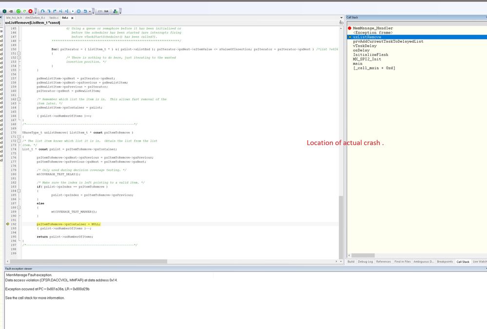

2022-04-13 11:32 AM
Thanks for such a detailed response.
I followed your advise and attached below are the screenshots for
I am assuming since uxListRemove() is the last function on the stack, and since NULL node is being removed, a crash happens. Would I be correct?
I am still looking into the exact location in the file where this function is called.
Thanks
Amogh

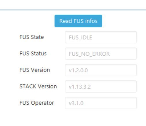

2022-06-29 8:55 AM
Was this issue ever resolved?
I believe I am seeing something similar: no SHCI_SUB_EVT_CODE_READY received using stack 1.13.3 and a custom app for STM32WB55 based on BLE_HeartRateFreeRTOS.
Unlike the report here, I see 0x20030134 at address 0x20030000 (so no Hardfault). Decoding the flash seems to indicate correct stack information at address 0x20030134 (v1.13.3).
