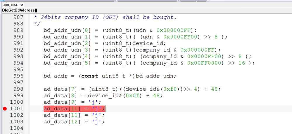

I would like to explain the problem a little bit more if possible.
BLE Stack works fine, but when I make small changes, ie uncomment line 1002, and 1003, I DO NOT get a SHCI_SUB_EVT_CODE_READY event.

ad_data is declared in app_ble.c, and I am just trying to change the local_name of the device, based on Mac Address. The problem is not just related to ad_data because even when I try to write to a characteristic and call a local function, SHCI_SUB_EVT_CODE_READY isn't received. I am not sure why and how something in the BLE thread can interfere and prevent the thread from even starting up.
Please see declaration of ad_data.

APP_DBG_MSG("SHCI_SUB_EVT_CODE_READY - WIRELESS_FW_RUNNING \n");but when I make changes to the BLE thread - like uncomment
line 1003: ad_data[12] = 'j'breakpoint/function in step3 is never hit.

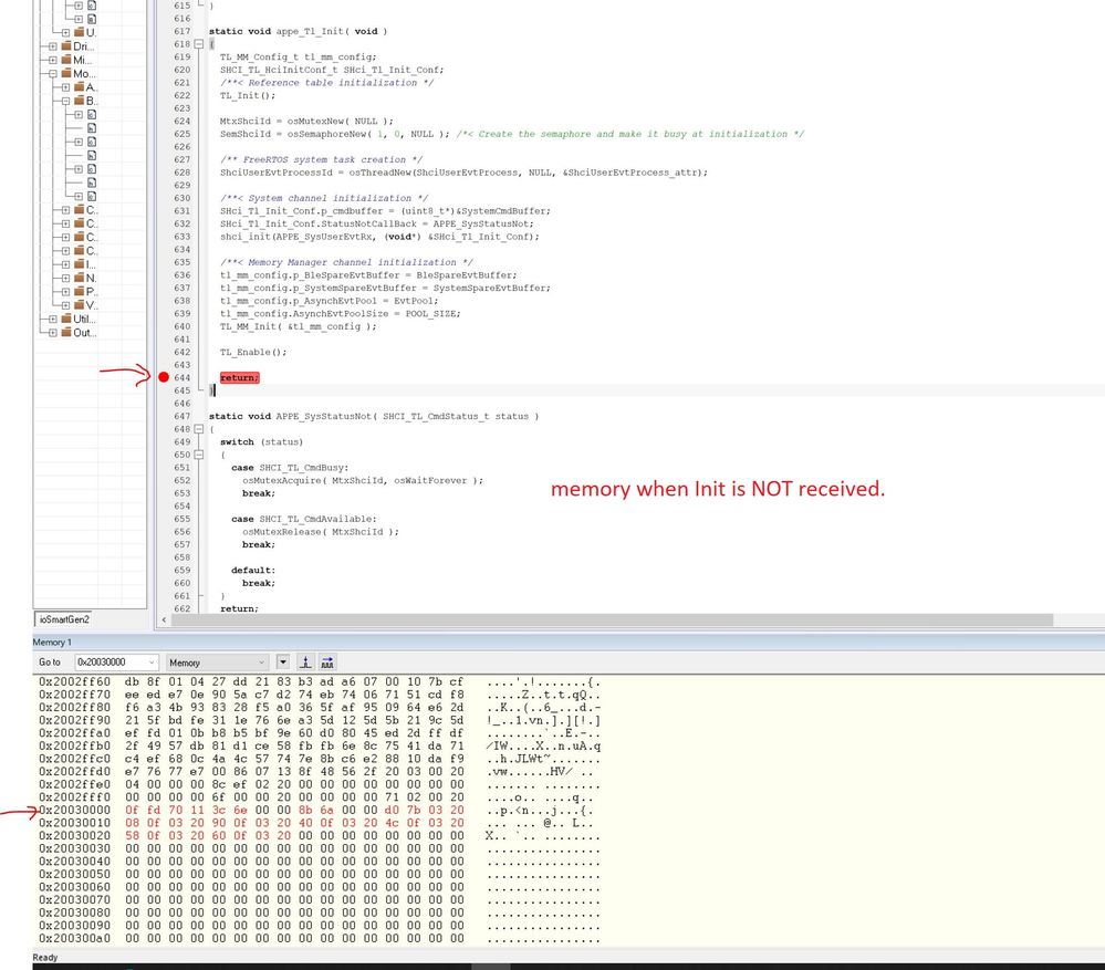

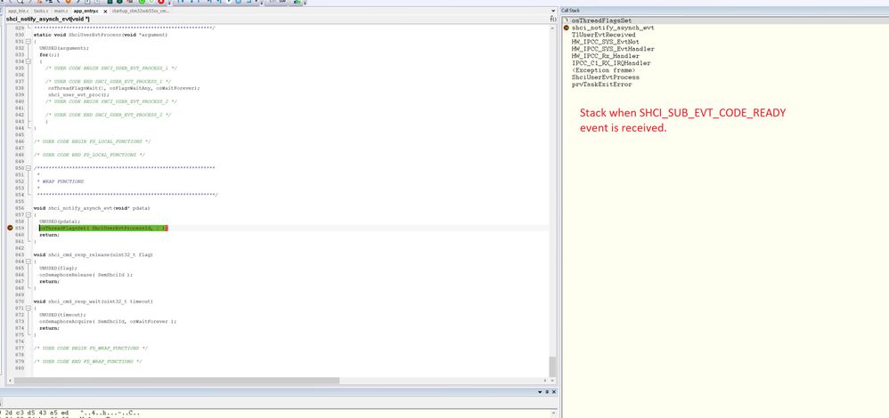

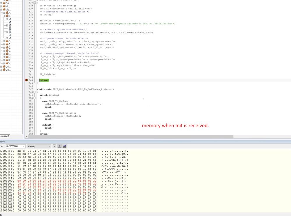

When SHCI_SUB_EVT_CODE_READY event is not received, can you stop your debugger, take a screenshot of the call stack please and look what the CPU is doing ?
Can you also take a screenshot of the memory content at 0x20030000 (first 4 word of 32 bits) ?
Can you add a breakpoint in shci_notify_asynch_evt function and check if you see the event or not ?

2022-04-07 10:16 AM
Thanks
2022-04-07 10:36 AM
The Rootcause of the problem seems to the the IPCC Rx interrupt not being triggered. What I dont understand is why would a change in BLE thread stop this from happening?
Thanks!
* @brief This function handles IPCC RX occupied interrupt.
void IPCC_C1_RX_IRQHandler(void)
/* USER CODE BEGIN IPCC_C1_RX_IRQn 0 */
/* USER CODE END IPCC_C1_RX_IRQn 0 */
HAL_IPCC_RX_IRQHandler(&hipcc);
/* USER CODE BEGIN IPCC_C1_RX_IRQn 1 */
/* USER CODE END IPCC_C1_RX_IRQn 1 */
