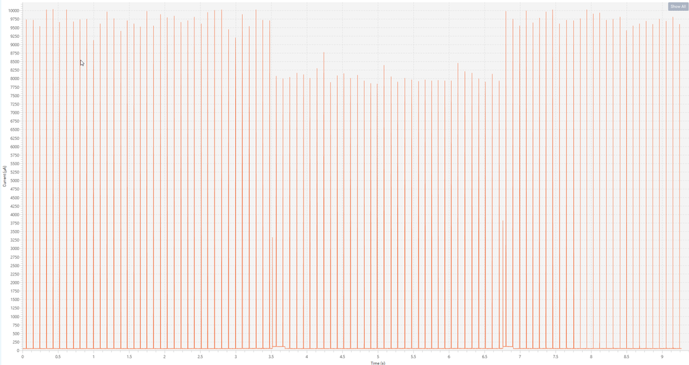

Using CFG_TX_POWER to adjust the output power should go without issue. But the most straightforward way is to use the aci_hal_set_tx_power_level(1, CFG_TX_POWER); function with a different second parameter. Here I switch between two levels in the p2p_server example.
You can search for the above function in the code generated for your project to verify that it is actually called with the correct CFG_TX_POWER parameter.
As for the difference between your consumption and what is achievable on a Nucleo - this is as STTwo-32 has said. It can depend on HW and the best way is to run you project on a Nucleo to verify this.

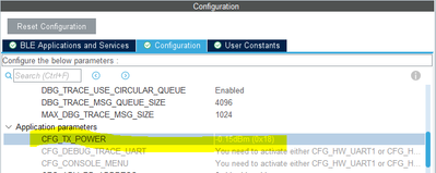

Thanks, but is there any info how to actually set the TX power level? In CubeMX, one can set the CFG_TX_POWER macro desired level, but the other two macros remain 0. Are they not relevant? It is quite confusing.
2024-09-02 5:04 AM - edited 2024-09-02 5:09 AM
CFG_BLE_MIN_TX_POWER and CFG_BLE_MAX_TX_POWER are the parameters that set the Minimum and Maximum transmit power in dBm supported by the Controller. The CFG_TX_POWER is the parameter that set the TX Power of the node. So, the TX Power is set on CubeMX Throw CFG_TX_POWER under BLE Configuration tab:
Best Regards.
STTwo-32
2024-09-04 2:00 AM
Thanks, that´s a really helpful example you provided.
